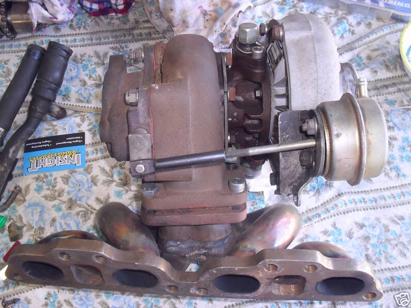

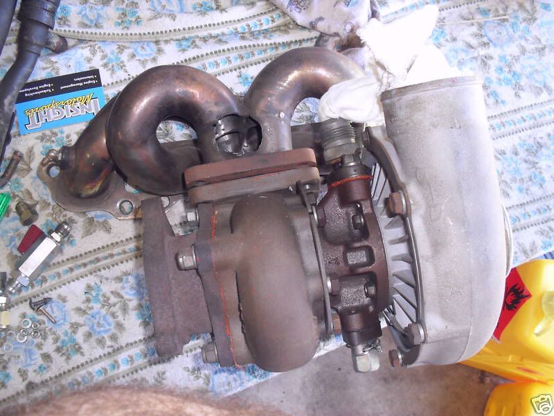

          These are the pics of it on e bay he said it came of an RS500, take no notice of the manifold, its from a nissan i think. Whats it worth .
            This is how the write up goes. Genuine Garret T04 fully rebuilt and unused since, T3 flanged with a .63 internal gated exhaust housing and a .70 compressor cover with 3 inch intake.
            What do you all think?
              To fit it you'd need a 2wd exhaust manifold, revised oil feed, some form of turbo damper and bigger hoses. You may also need to mod your exhaust downpipe to make it clear the ARB/Bodywork.
              Thing is, unless you do engine work, all that turbo will give you is more lag. Its possible to get over 400bhp on a standard engine, but in real worl conditions it'd probably be slower than a good t35 engine...
              In my opinion i'd hybrid your own turbo, fit bigger injectors and a new chip - aim for around 370bhp on your 35
                put simply, after all is said and done you will need head work to make use of the extra air a T4 can flow
                  Whats involved with hybriding my own turbo what does this mean and how does it work better? ie more flow. what head work would i need to do to get the T04 to work well.
                  TONY. This tubo in for sale at a starting price of $800 witch is about 460 quid buy it now for $1000 , 577 pounds.
                    Cheap turbo, but you will need a hell of a lot of engine work to make it work, and your gearbox will need uprating.
