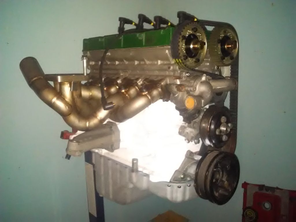

                          Well... Have ordered new since didnt find them in storage....Today when looking for something else, i found the old spacers from this engine.. IT looks like oring is beetween bearing and spacer yes, so thats were i put them now. That also looks correct, since oil cant pass the spacer since outher seal runs on IT, so its the only place to put IT in the chamfer in spacer that hit bearing Center.
                          So now its almost ready...
