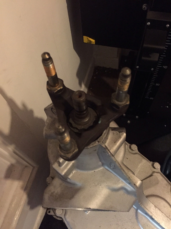

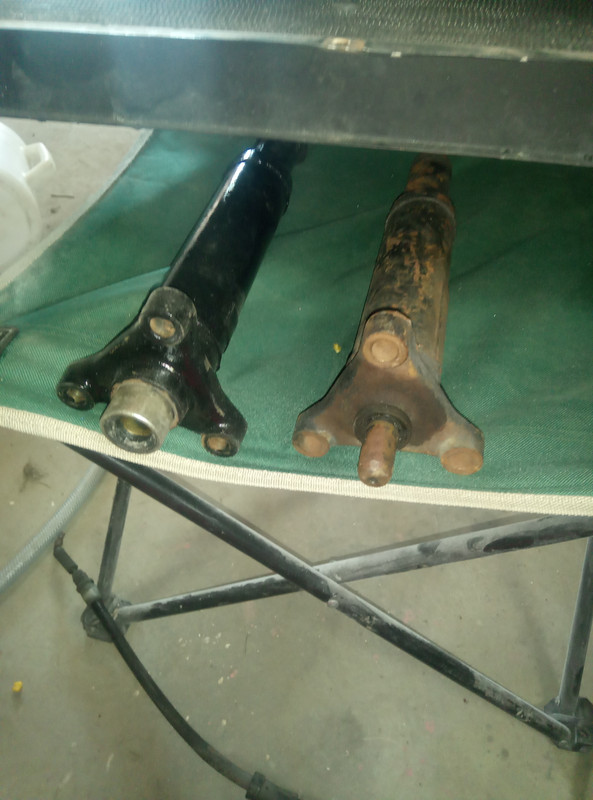

            These pictures are from my car, the gear box had longer bolts which I changed for escort ones and the prop set up is all escort. The box came from a sapphire 4x4 on a G plate. Is that centre pin in the picture what you are referring to?

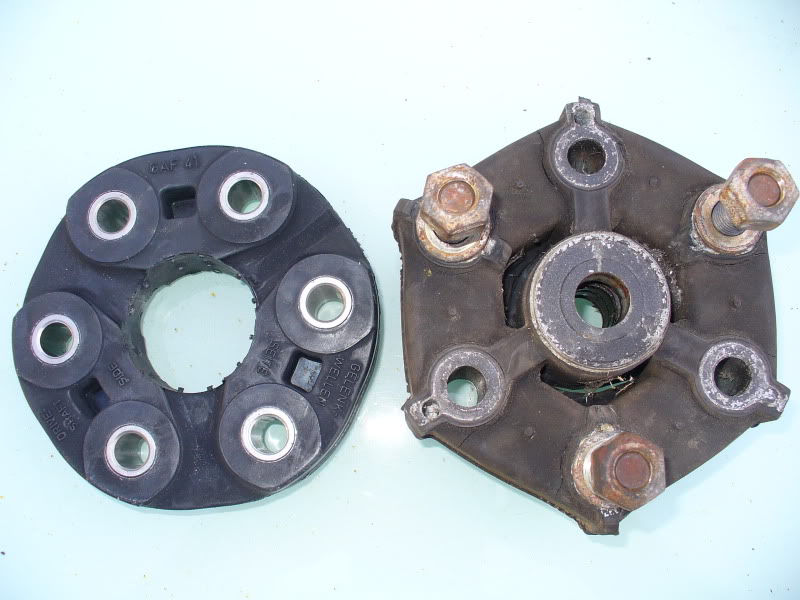

              Yes the centerpin. On later Sierra and Escos the outgping shaft in gearbox have longer centerpin, donut and front section of prop is diffrent, when you use early gearbox with later donut and prop, the centerpin dont reach prop.

                Late sierra/Escos
                Late left and early right

                  I think i understand from the pics, but what year would be a late gearbox so i know what to ask for?
                  thanks for the heads up.
                    91, but just get pic of the rear, so you see its the long center pin(if you still have that) problem is that boxes might have Been changed before, som check always... I just found early box in my Sierra 4x4 prosjekt i bought last now, wich is one of the last made, since box had Been changed before...
                    So check wich donut and prop you have, so all is correct
