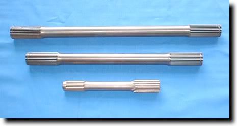

    Its me not reading the post properly, I thought peeps were talking about 2WD rears. its been a while since I saw a 4WD rear shaft..lol....I cant understand why you bought a whole shaft as the 100mm joints are available seperate from Raceparts...
    http://www.raceparts-direct.com/prod...ints+%26+Boots
    The bare shaft itself is the part that will need manufacturing by someone like DOME or Doughty, the joints are available for whatever application...

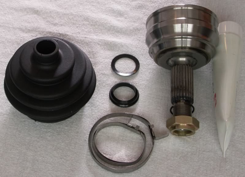

    One of the cars I used to look after years ago (with i'm nearly sure the R & D front diff used the Audi 100 Outer C.V's)
    Because a drive-shaft complete was half the price of a pair of the new ones and readily available . However, I have saved this site, as it is good to know. Regarding the shafts, that is probably where Bara got them from LOL.
      Originally posted by Tore_TJ View Post
      Did I understand this correctly: you can use a audi 100 outer joint on a standard shaft and hub, and it's stronger?
      Tore,
      No i think i may have mislead you pal, I was refering to mike and wenny...some the escorts we've see in rallies that arn't 100% built to a spec used modified front diffs such as the R & D mike has, they were a cheaper option than say a 7 1/2" FFD or an Xtrac, some of the rally lads mated the R & D to Group A gravel hubs with the larger bearings and drive train, one of these cars had custom length drive shafts, used 100mm inner CV's and had an Audi outer CV...the outer CV info for mainly meant for Wenny if he is using the Grp'a' hubs on his new car....
      Bare shafts can be made to any length with spline configuration to accept competition joints, all of which are readily available (at a price of course) lol

                  The audi outer was used by a few people I think DOME might have had a hand in doing it...
                  Pal of mine Bob Green used the audi outers onto a R & D front diff..
                  The outer drive flanges were IIRC early sierra group A which had a smaller spline pattern and were compatible with the audi outer cv...
                  I would imagine you're using a later drive flange and as such you'll need some grp 'a' outer joints...as Steve will tell you it's getting harder to find good joints we have both had to bite the bullet and get new ones off Dewitts..
