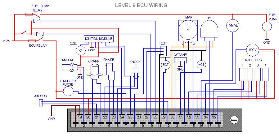

Right, been through the mill with the cossie recently. Kinda since just before the rolling road day all sorts of probs have arisen.
Thought I had a TPS problem on the way back from pod, hasn't done it again since though
And now every so often with the ignition on before starting, the fuel pump will keep running and the car won't turn over (presumably because of the extra drain of the pump running)
Now there is an interesting symptom to this - when it happens, the ISCV is OPEN with just the ign on as when I unplug it I can hear it close. The fuel pump then stops!!!
Proper baffled!!!
