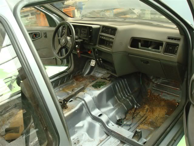

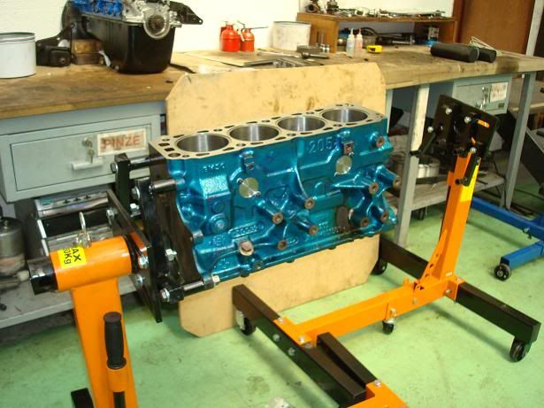

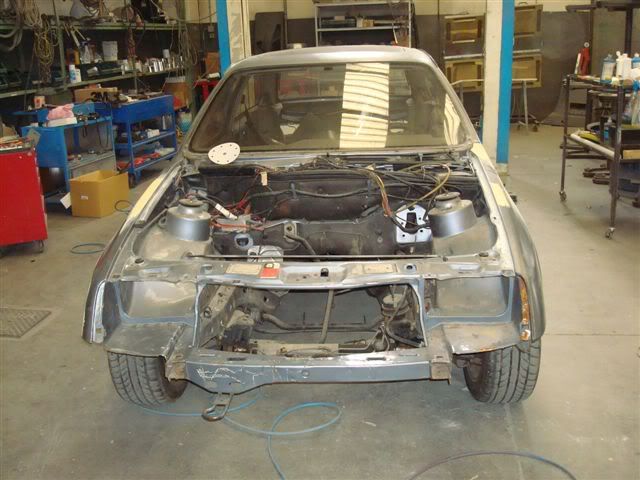

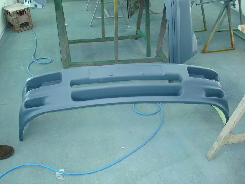

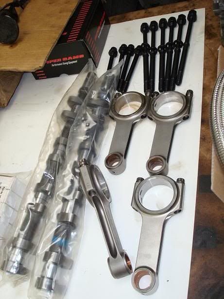

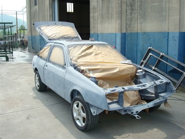

    hello,
    here you have my new project...

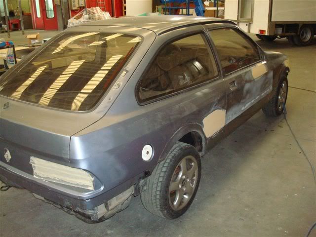

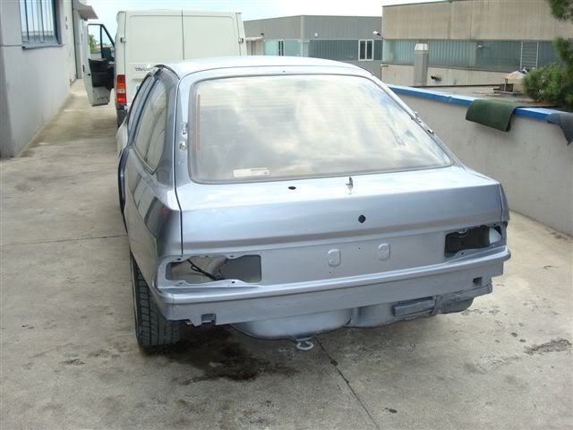

    the new spec of the car is:
    BODY:
    rs500 front bumper
    rs500 rear spoiler (lower+upper)
    new paint moonstone blue
    compomoptive 8x18 front and 9x18 rear in antracite
    front early type sierra mk1 headlights
    SUSPENSIONS:
    gaz GGA gold coilover kit
    adjustable rose jointed rear beam
    adjustable front tca+compression kit
    gpA antiroll bar
    TRANSMISSIONS:
    7.5" gripper lsd diff

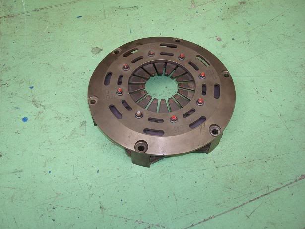

    ap racing twin plate clutch
    T5 borg warner with 5 speed dog box gearkit
    BRAKES:
    300mm rear brake conversion
    362mm 6 pot Ap racing front brakes
    ENGINE:

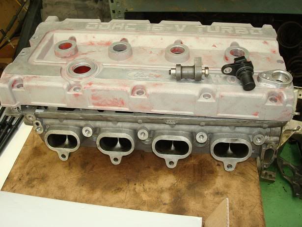

    RS500 mountune gpA block MT004
    6 long studs
    oil spray jets
    accralite forged pistons 8.8:1 cr
    h section con rods
    big spec pipercams camshafts
    double valve springs
    solid followers
    big ported head 28mm726mm
    mountune roller barrell manifold
    uprated oil pump
    tubolar manifold
    wrc external wastegate
    hybrid twinscroll turbocharger
    wrc airbox with pipercross filter
    GGR 3 port breather sytem
    GGR header tank,swirl pot
    rs500 intercooler
    alloy radiator

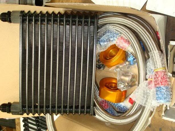

    oil cooler kit

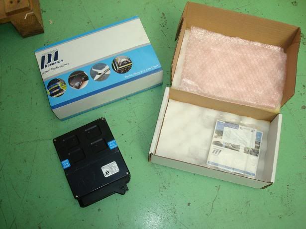

    ELECTRONICS:
    pectel T6 motorsport ecu

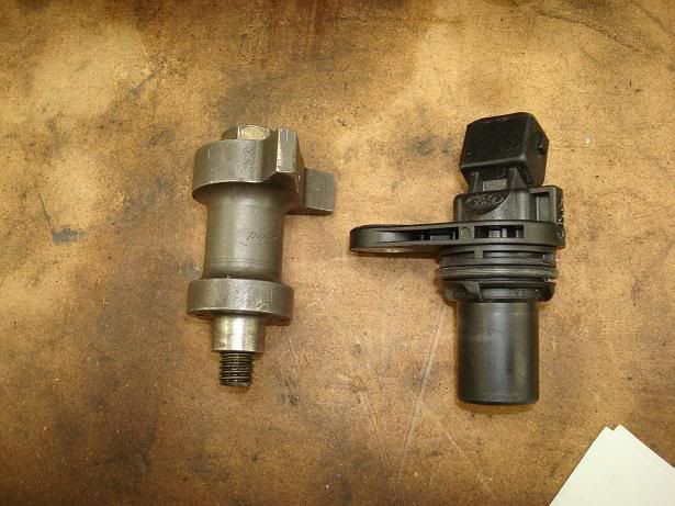

    coil pack+cam pahese senor on rocker cover
    8 injectors setup
    air injectors
    stack dash
    stack wideband
    Oppliger Romain
    www.oppligermotorsport.com

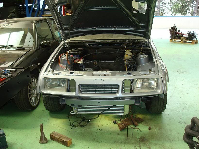

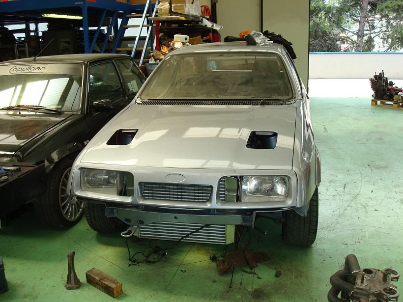

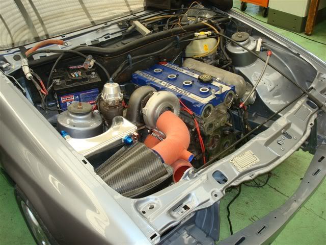

    LOVE IT! Now you need to check your PMs to see about sorting a group buy on your gearkits, as Mark has reported favourably and now you have a ton of people wanting one, but you disappeared off the face of the planet .

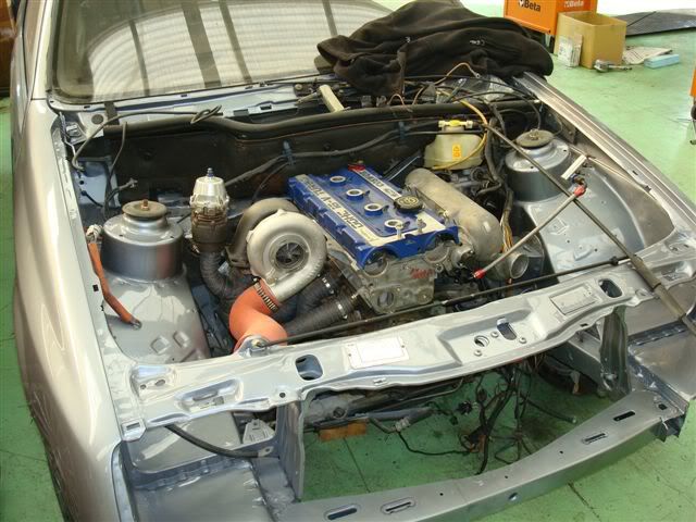

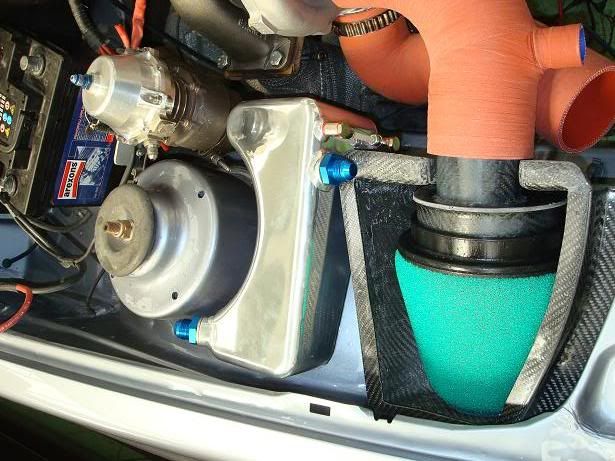

      Nice one, BUT that battery concerns me where it is!!!
      BOSCH PARTS 07759984033
      INJECTOR CLEANING
        What the original factory location on LHD cars?
          Mike you flid did they come with external wastegates and no heat shield then? I can see why you choose who you shop with!
          INJECTOR CLEANING
            You absolute flid - does the car look even remotely finished?

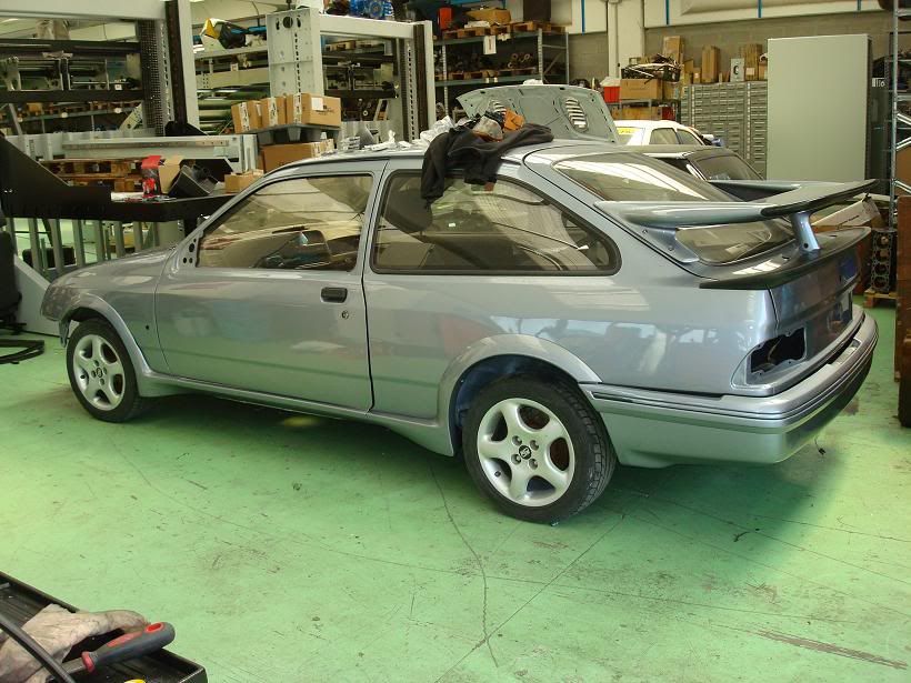

                looking stunning bud
                  very impressive car .
                  Low Slung Denim.
                    a moonstone blue 3dr is another on my want list with a s1 aswell... Looks lovely so far mate, keep at it..

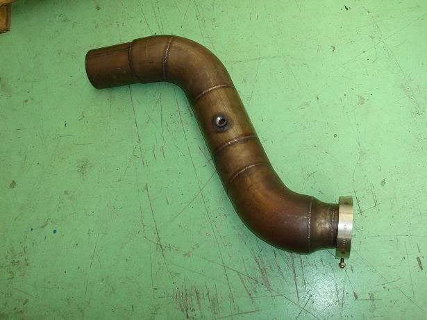

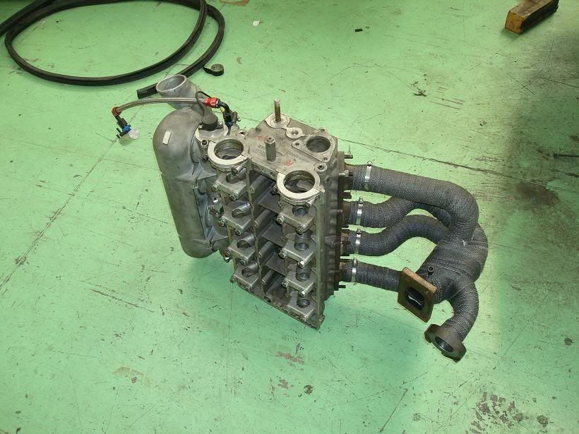

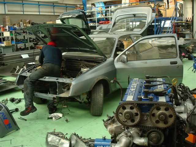

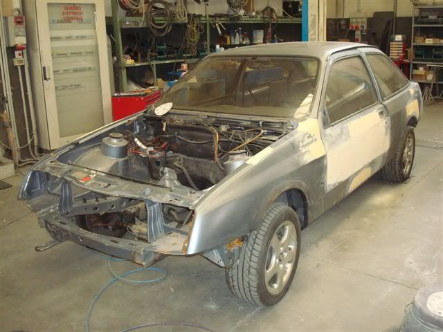

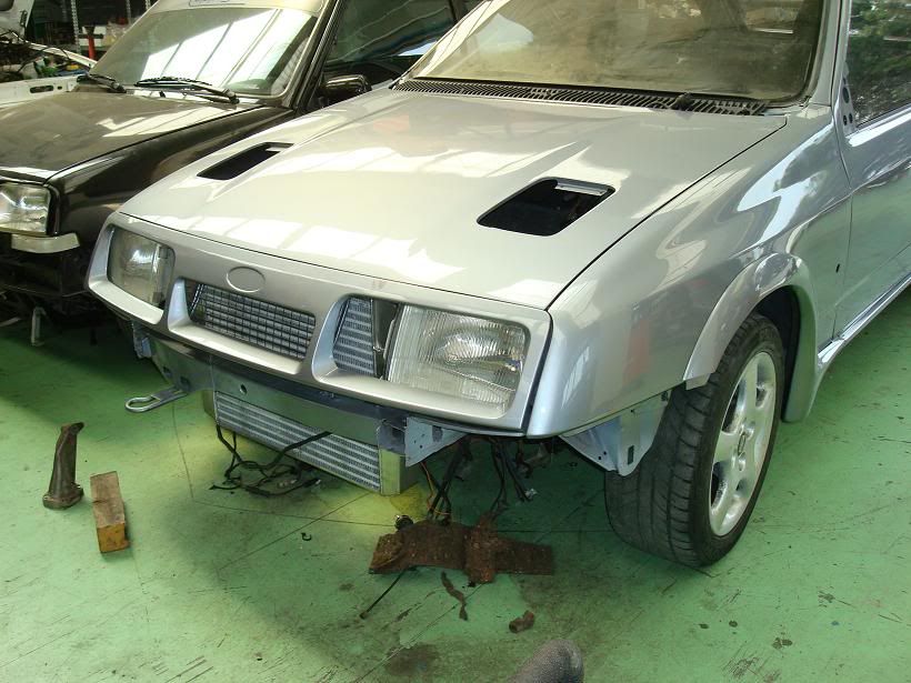

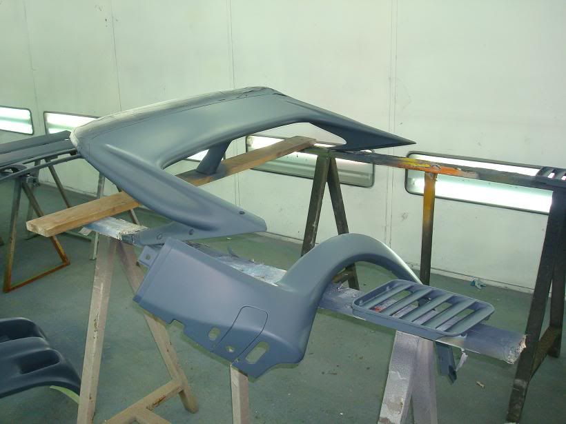

                      hello,
                      thanks a lot...here you have new pics of progress
                      Oppliger Romain
                        What wheels will end up on the car?
                          very tidy job heatrapping the manifold
                              thanks mates....about wheels i have ordered compomotive Mo 9x18 rears and 8x18 fronts
                              with semislick tyres
                              thanks
