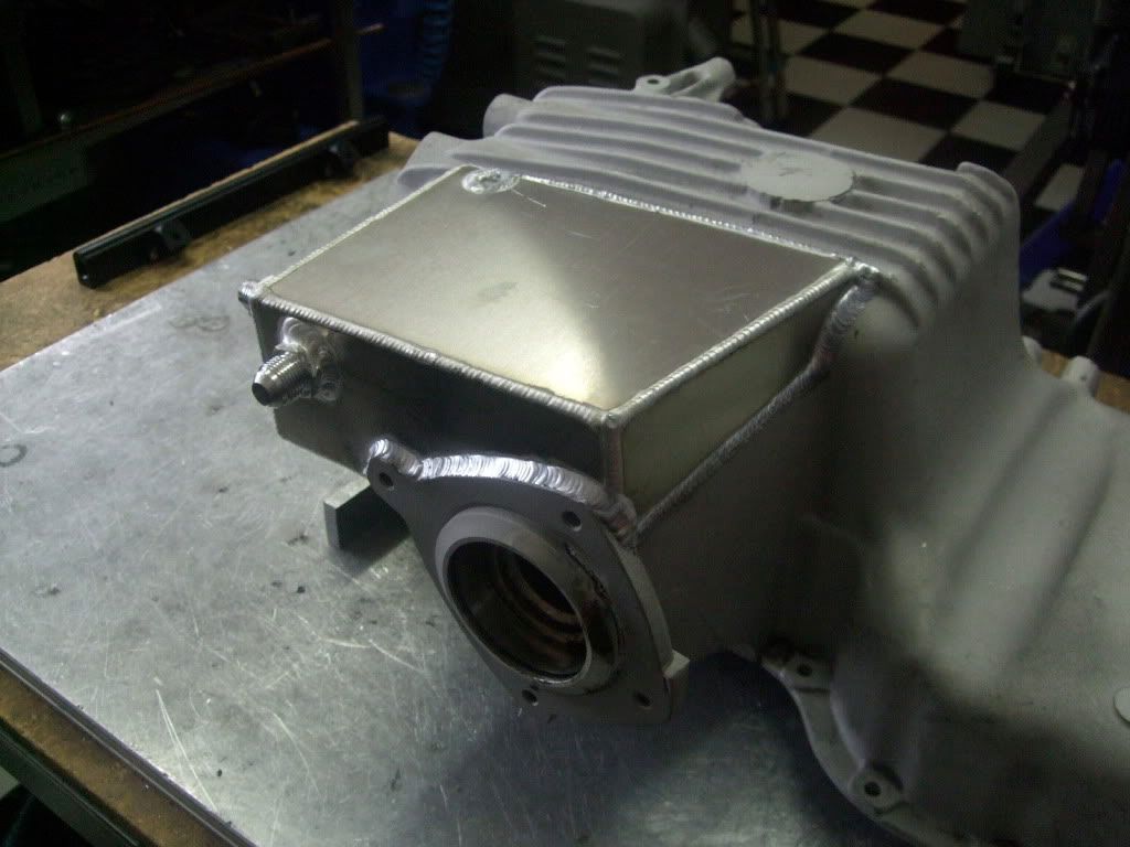

can you powder coat your sump or is it best to paint it?
  • can you powder coat your sump or is it best to paint it?
    just had my cossie 4x4 sump big winged by mk motorsport
    he bead blasted it for me to clean it all off etc but now i think id like it painted/powder coated black or grey,
    would the powder coat survive the temp of the oil etc
    thanks Marc

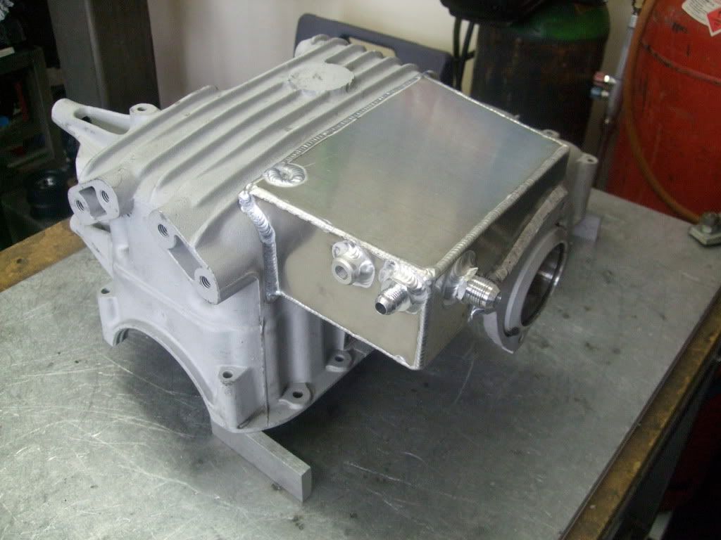

                  i did all this in normal straight colour:
                  trick to getting it to last is good prep, clean so nothing to contaminate, good etch primer, then I put flexibliser in the paint (like you use on plastics), as this allows it to expand with heat and not crack or split. I've painted hundreds of items over the years, never had one issue. Even the cylinder head and block on the above were done and they were fine after 10k miles, pretty sure the car is still going now too.
                    It's aluminium, why would you want to paint it - are you a homosexual?
                      tbh i was thinking the same seems a bit pointless!?
                        Was easier to keep clean once painted
                          We have seen the evidence above - say no more - it's official - you ARE !
                            Si, that looks fucking horrible could of chose better colours
                              i actually think when chemically clean as above they look nicer normal alloy!
