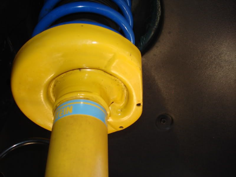

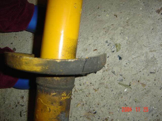

        Note that the spring cups may foul on the tyres (depending on what you go for). This is why people say about coil-overs. However, you can mod the cups to clear, or tweak them with a rubber hammer. Normally only needs quarter of an inch.
        See photos below:
        Rubber hammer mod:
        Cut and reweld mod:
          GGR Spring, same mod to Koni struts but didn't weld the piece back on.
          And this is how it sits....
            not sure about that mate if your tyre was to touch that edge it would be a bit nasty, you must also have a freindly mot tester!
              Why would that be Matt?
                That shock is supposed to be an MOT fail if left like that as the spring cup is incomplete.
                  Not keen at all on that spring cup, mine just need a light tweek with a rubber mallet like mike has mentioned above, didnt break the paint either
                  Also if you original shocks are in good condition just get some lowering springs
                      I don't have a 'freindly MOT tester..... However according to the guidelines for MOT testers..... There is no part that says the cup is incomplete. (Maybe broken or excessively damaged. but in my mind it is neither)
                      We will see come MOT time i suppose.

                        Ahh, I see what you mean, depends if they view that as broken or excessively damaged or not.
                          Graham, I certainly wouldn't even consider driving a car with a spring cup like that.
                          Would be surprised also if it passed an MOT like that.
                            i think ive mentioned this before but surely all the strength has now been removed? theres nothing to stop it opening up and bending downwards??
                              surely a small spacer would be better to use than cut the platform.
