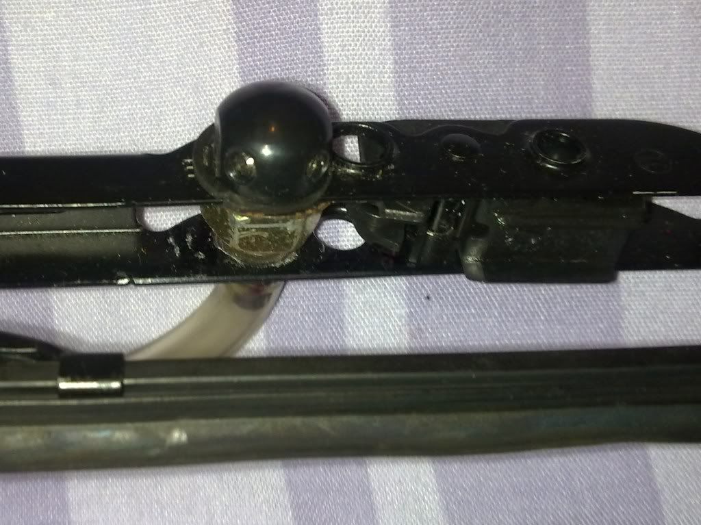

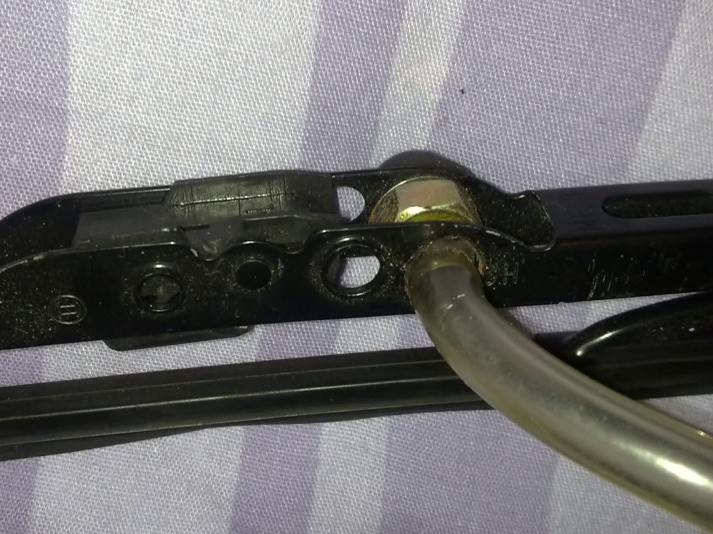

                            easy to do.
                            Take one standard off the shelf bosch blade, add an off the shelf set of washers from any decent car shop and take advantage of the holes bosch left for you! If the holes arent right, drill your own.
