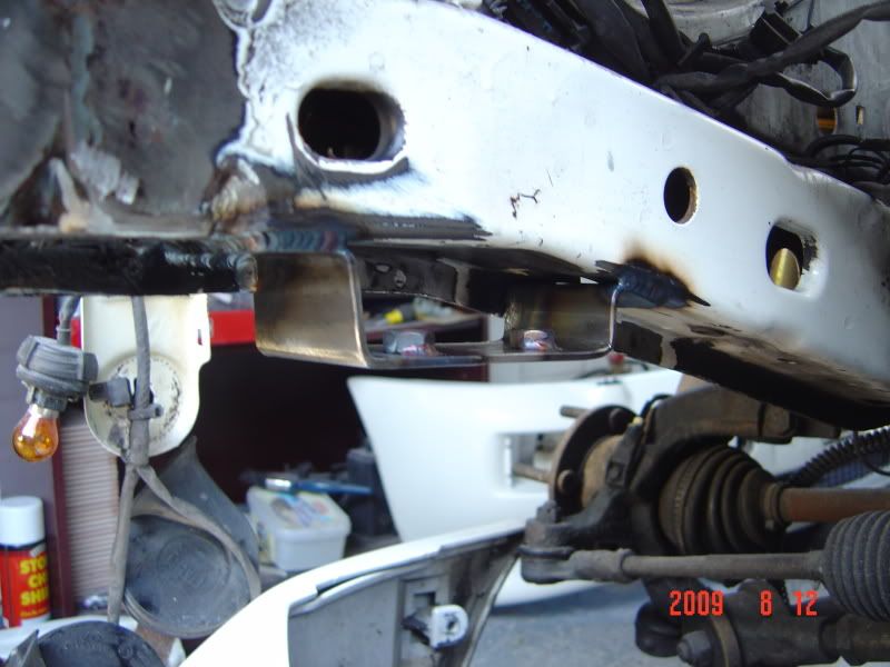

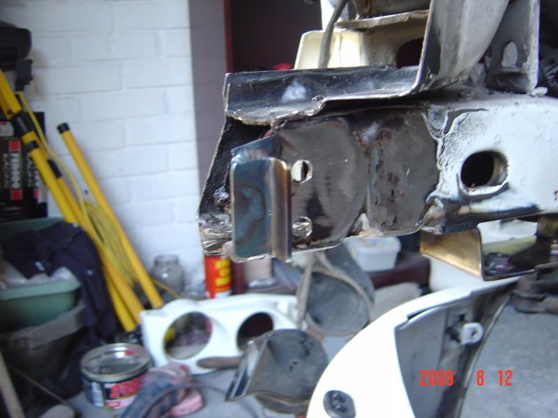

[QUOTE=Mike Rainbird;113586]Some photos I should have taken and put up from the weekend, but was too busy, so here they are now:

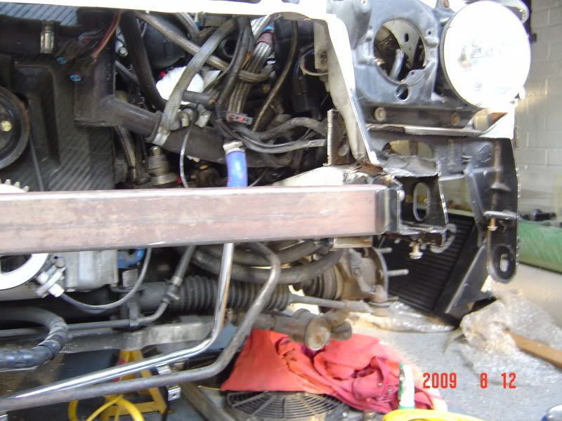

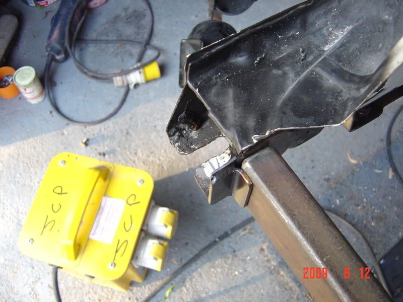

These are the brackets for the intercooler and radiator, so they are mounted separately. I thought this prudent due to their size and weight :

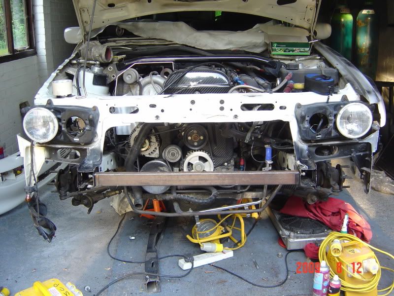

I then decided to have the crossmember removable to make life easy when it came to removing stuff. Now the intercooler can be removed without draining the cooling system and having to take out the radiator first :

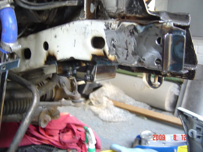

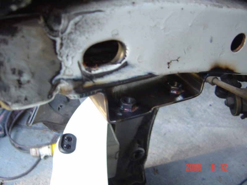

The L-brackets are to make sure that when towed, the weight of the car is not reliant on just the four bolts :
The cross member is made out of a beefy piece of 40 x 20 box:

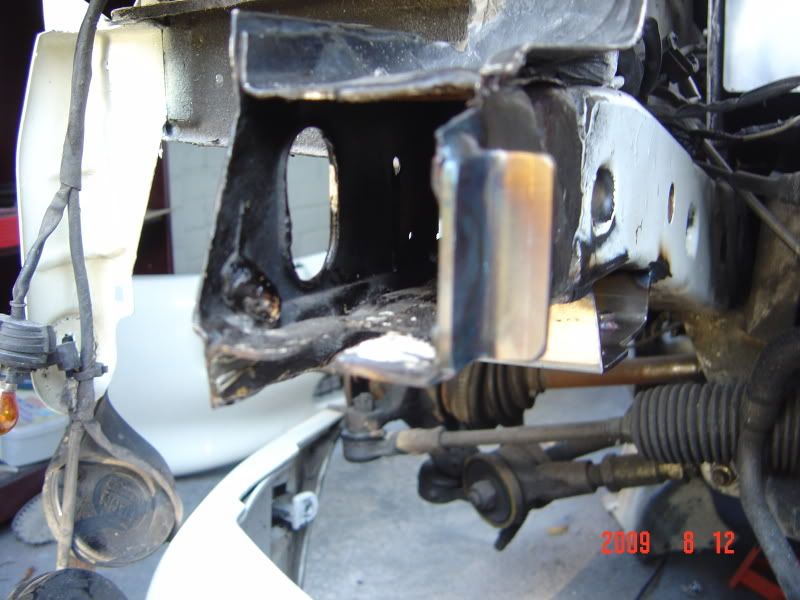

To give it more room and airflow, it was also modified from this:
to this:
Might be a bit subtle for some of you, but quite a bit was removed where it wasn't needed, and has had the result that the Morrettes fit better as well . The towing eye thread just needs to be cut from the original and reinstated in the correct place (a job for
Same as mine Gaz, it's a simple job to do.
The old panel cuts out in minutes, it's just then down to how long you take to make it nice and tidy but I know you will do a good job of that.
