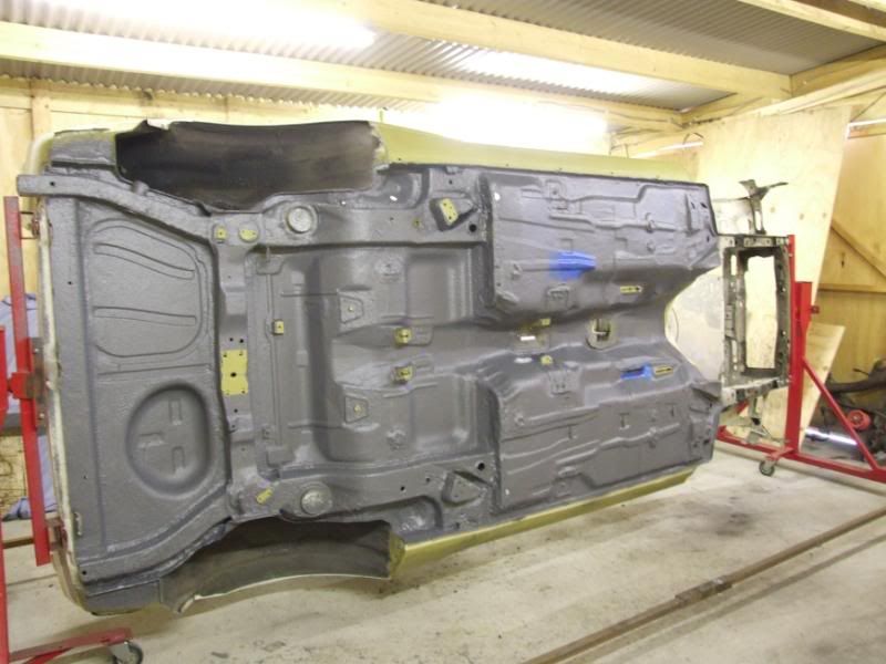

            You don't have too but there is that many different brands this is what was on mine roberlo hydrotec its waterbase and does not need to be painted and comes in white grey or black.
              Not going to the extreme you went too cosiedevil .Ye stone chip its going too be .I think shutz is a little bit messier.
                i can understand that brianHydrotec is a stone chip the pic just show what its like dry for ya think its €15 a tin
