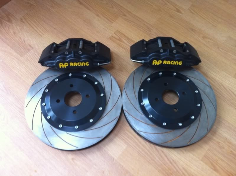

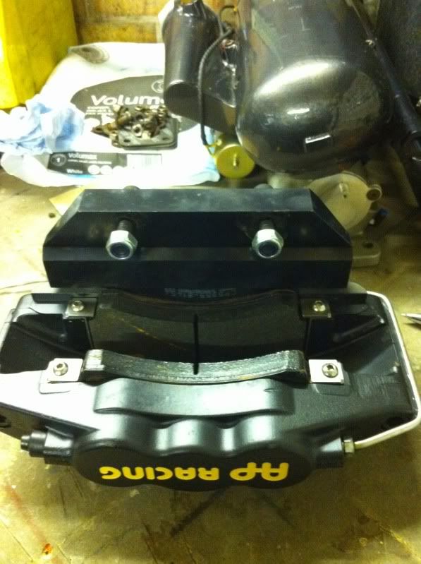

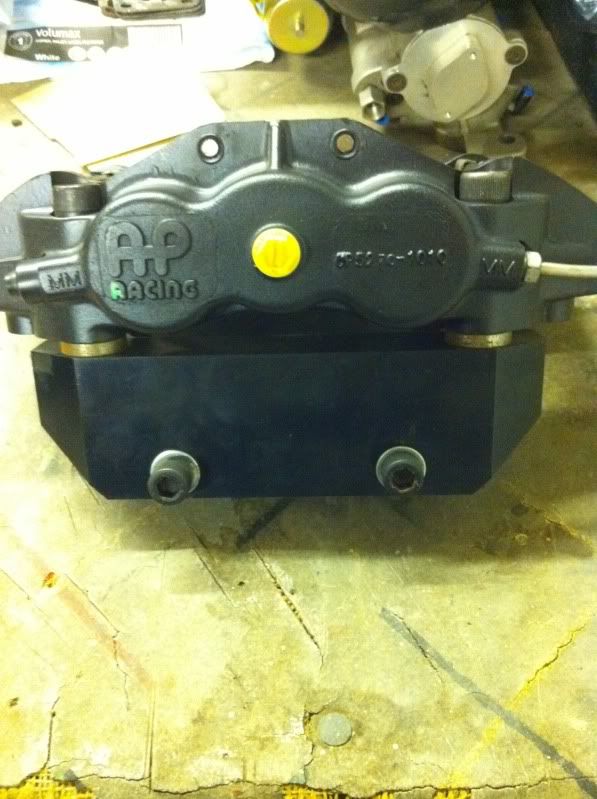

        will do kelv as i dont wana shave them to be honest as with my luck will nacker them and be well out of pocket bud- you have pic of the cp5555 caliper handy?
          Erm, all ive got are these Gaz.

              cheers fella il make few fone calls tomorow and see were im headn.
                Don't bet on the 5555s fitting either. We had to shave Mark's to get them to fit behind his 18" Monte wheels.
                  imagine how much you would have had to shave off if you were trying to fit the 7040 calipers then, it probably wouldnt have had any strength left afterwards
                  but in fairness, the MO's do give more clearance than the Monte's.
                    file the edge of m8 i had to do it on mine with 362s
                      I have the 5555 caliper on my escort and have had loads of different rims over the years and one being the old style MO in et 15 and they didn't fit over as standard but I stepped my discs back 7mm and then they fitted fine but needed to get new bells and brackets made plus I gad to Rose joint my track rod end to gain the gap to step the disc back and it now just misses it
                      But doing this has helped as my rotas would have not fitted plus other rims I have had
                      Dunc
