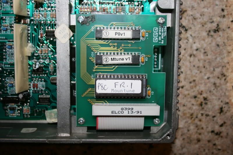

    OK here goes, i would like to start upgrading my ECU. And possibly power output of my engine. At the moment it is stage 3, about 330BHP.
    At the moment it has a 3 bar MAP sensor, Light blues, Mountune chip on a pectel board, RS 500 style intercooler, 3 inch decat exhaust .
    I will put up some pics of the ECU with the cover off it.
    Here in OZ we dont have very many people that are able to work on cosworth Engines and ECU,s .
    Later this year i will be coming to the UK for a holiday, would it benifit me to bring my ECU over with me. and get the upgrades done and mapped over there, then fitting it back on the car when i get back. Or buy one already done, or change the ECU all together to an after market one that can be mapped here in OZ, if so what would be the best one to look at.
    What would be the best to do?
    I would like to start with wasted spark, and anti lag. May also look at launch control, can it be turned off like the anti lag? Dont know much about the launch control but if im getting an antilag chip i may just pay the extra and have the launch control as well.
    Would also like a power upgrade.
    Pics of mine.
