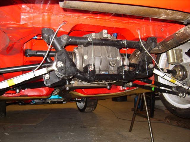

                Thanks guys and as Steven said my cardle bolts to the cage pick up points like this one.
                  Wat i meant steven was as u can see in the pic above u dont use the original diff bolt holes but the crossmember has to cut and rewelded like above but im not sure if thats only to suit the big diff or wat
                    I think this is only done jason to fit the big diff
