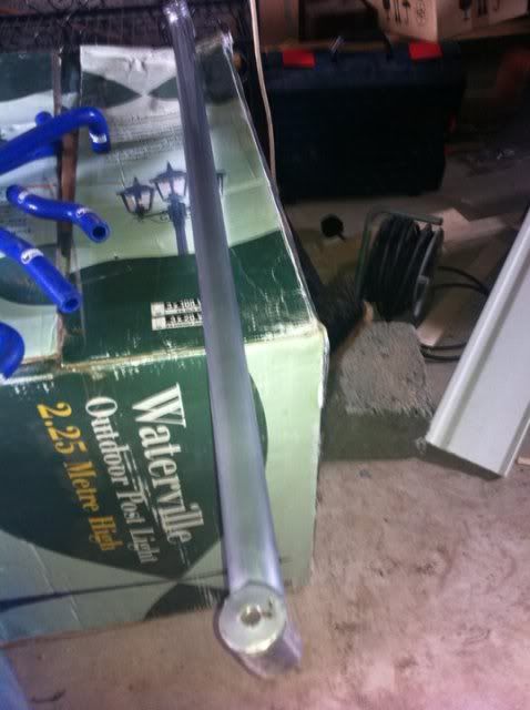

    Right guys needing your help,I had a rearP strut brace on my last escos took it off and never bothered putting it back on i sold the strut brace but Adam is having difficultly fitting it to his here's the strut brace bellow can someone please tell us how it goes back on it been a few years since i took it off

    undo the top shock mountings then putthe brace over the bolts at each side then put the nuts back on.
    you might have to jack the car up to help line it up

      Thanks Steve
        surely the bolts wouldnt be long enough to go through the brace?
          I bought a new rear strut brace and it came with longer bolts, you won't be able to fit it with the original length bolts.
            on that type you can get away with the std bolts as it isn't a full depth tube it's like an open tin can and the nut will be inside it

              I have the same omp strut brace in my car and yes you can use the same bolts as they go inside the strut brace as per steve's message.
