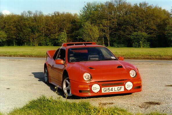

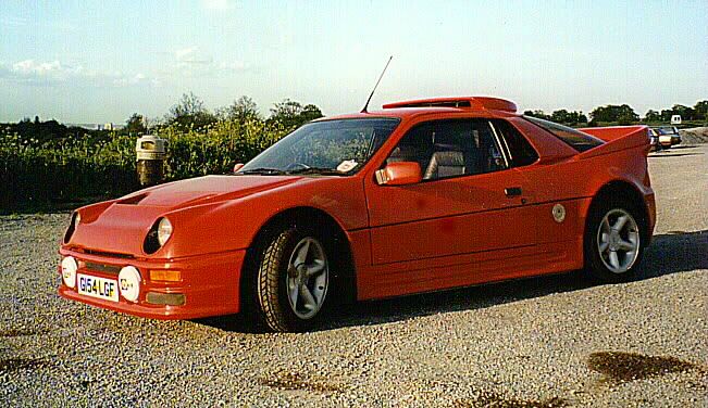

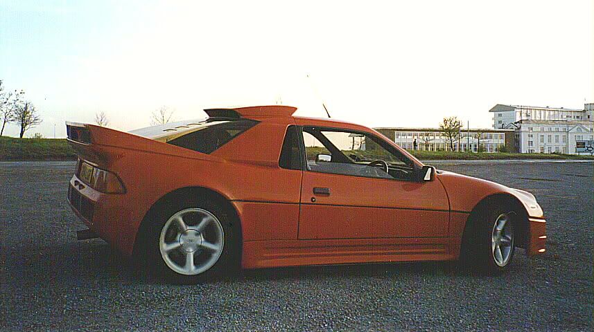

      You can get them:
      not sure who makes them though. The one above was RWD.

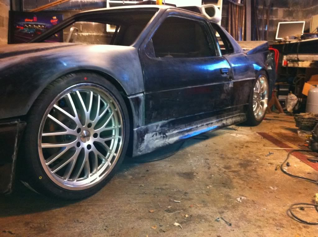

        It is a guy here, who building one now.
        He bought chassie and frame from RS Motorsport www.evo200.com

              This is the one under building here. Yb engine and un1 gearbox
                The red one is YB apparently.
