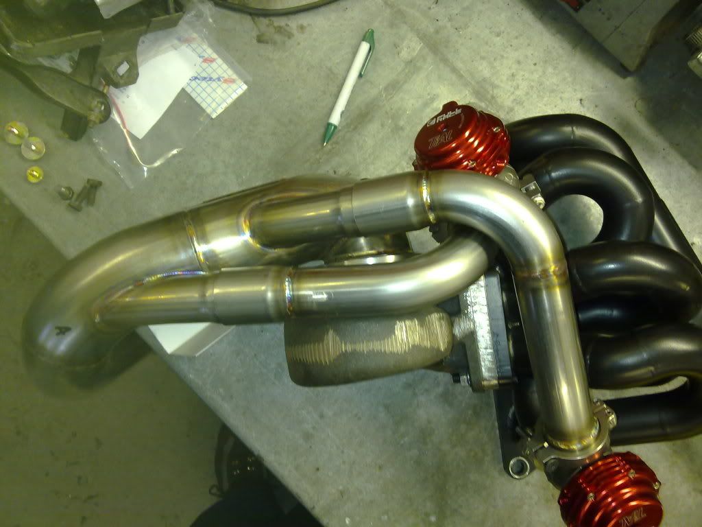

              Heres something I did ealier.

                  heres the start of my 3.5'' currently working on the centre boxes to split for side exit

                      That looks a work of art
