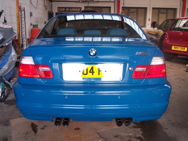

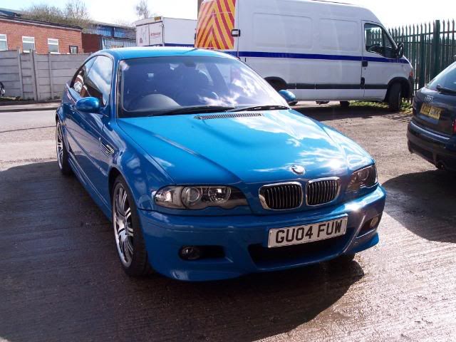

              Cheers, i think ill look for a manual box then I quite like that blue, is it the laguna seca one? Looks good. Cheers Dan Is there any way to check clutch wear through the computer? Im looking for a 04 on wards car with fairly low miles so im hoping to not have to many issues.

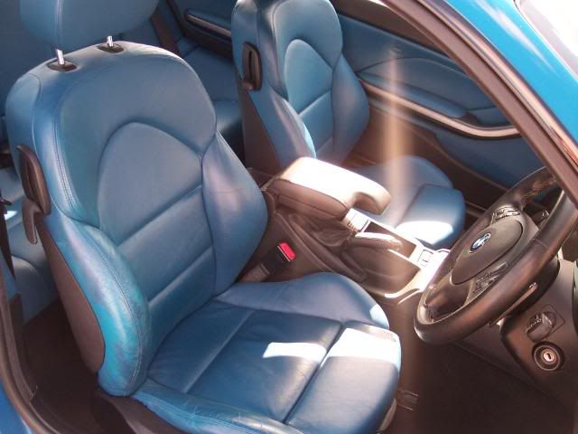

                Leguna seca is the colour I wanted, but didn't like the leguna seca interior most of them have. Steer clear of the grey interiors they are hard to sell on. With the clutch I think the only way to tell is clutch slip or slight vibration through the car on idle. Be aware the clutch can slip with fast gear changes as they have a clutch delay valve as standard which I think was designed to protect the drive train.
