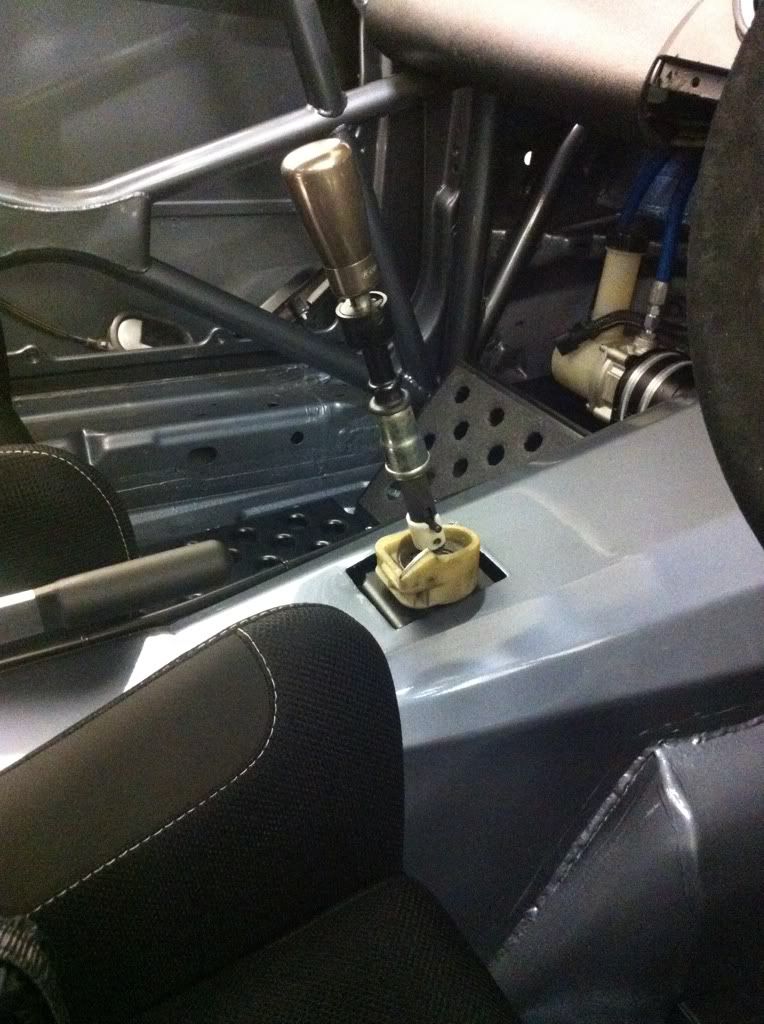

    Because my box is very high up in the car the gear lever was high but ok but due to the lift reverse mechanism there was alot of play due to the rubber bush inside the lever rod and I don't like that, so as my lift up reverse didn't really work, I think as its old and worn it would go in anyway whether you lifted or not, I have done away with the lot and shortened the lever, it's now nice and tight with no play
    As far as I see it will not easily go from 3rd or 5th into reverse anyway so shouldn't be a problem
    Anyone else done this?
    Here's how it was

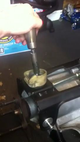

    This is in reverse showing the lift pin would
    make no difference
    This shows the gear changes etc

    Not sure if the height is perfect yet but this can be sorted with a sleeve when I know exactly where I want it
    is it litterally just that white plastic edge that stops it going in reverse??
    mine doesnt work either.
      There is a pin that sticks out from the hole you can see, so even if the pin was in then it wouldn't work as the plastic has worn back
