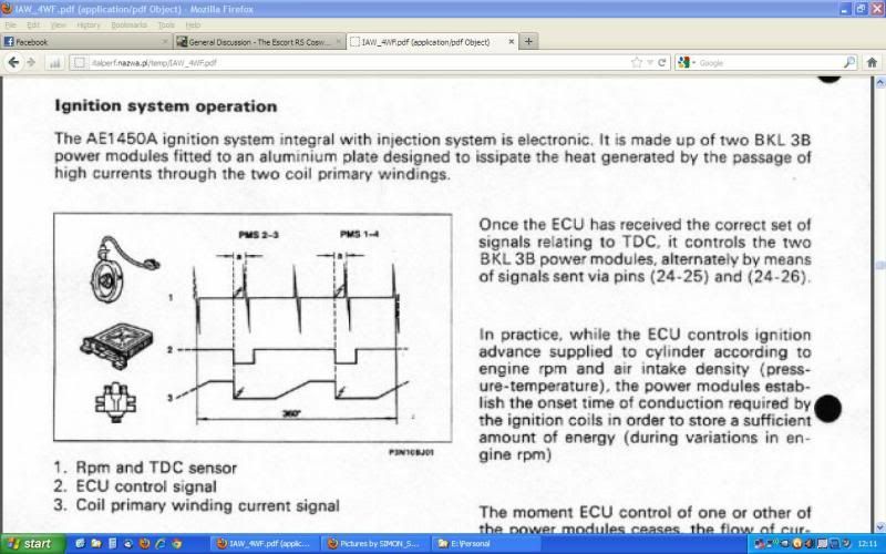

                        Just to double confirm the above...
                        I have hand written notes of the time I used an oscilloscope when I designed my own ecu and the MSD Coil pack adaptor and verified my comment.
                        I tried searching the net for official datasheets but this is the best I could find and clearly shows the control signal (2) "falls" to fire the plug.
                        This data isnt for the cossie but it is the identical ignition module used so is valid
                        The PDF file where that info came from is here ... http://italperf.nazwa.pl/temp/IAW_4WF.pdf
                          [url]http://i213.photobucket.com/albums/cc226/SIMON_SECS/IAW_IGNITION.jpg/url]
                          The PDF file where that info came from is here ... [URL]http://italperf.nazwa.pl/temp/IAW_4WF.pdfURL]
                          Bloody excellent!!!
                          I was hoping you'd come along! This made it alot easier.
                          Is the dwell time above correct? Have you got the full rpm dwell table perhaps?
                            No I dont have a dwell table but that time is about right
                            The module does control dwell all by itself to a point but if you have too long dwell times from the ecu, the heat sink will get very warm.
                            Just a word of warning... Driving these modules you must have a proper signal ground
                            You can drive the input with a 5 volt signal or an open collector driver as the module supplies a bias voltage if you understand that.
