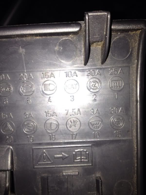

    Hi guys,
    Trying to help a mate who's car won't start and is constantly popping fuses the second the ignition is turned on.
    Fuse number 3 (10amp) is shown as KAT, does anyone know what this is actually for and what it relates to so we can start to look into the issue.
    Thank you

        Try unplugging the lambda then turn the ignition on and see if it blows kelv I had a problem like this a few years ago but can't remember the fuze number and it was the lambda worth a try

          Fuse 3 is the lambda sensor

            I'd start with putting a 20 amp fuse in, as that's what it's supposed to be!!!

                    Different to what we had Kev, but conquered it now.... Almost, melted plug on the lambda sensor

                          there is a conflict here if you look at the fuse ratings on the info sheet and then look at the fuse box cover
                          fuse 2 according to the info sheet is voltmeter and should be 3A and fusebox cover says 30A ??????
                          is it big and small turbo difference ???
                          OLD FORDS DONT DIE, THEY BECOME CLASSIC
                            the covers are for standard escorts,cossie is totally diff so just ignore the cover panel,there wasnt a cossy specific one
