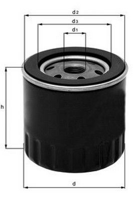

              Excelent fellas thanks, i also got this from the net.
              It had the mesurements. as well.
