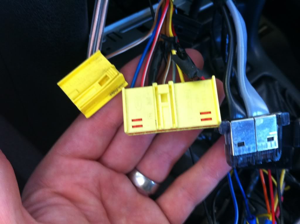

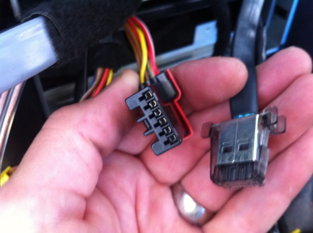

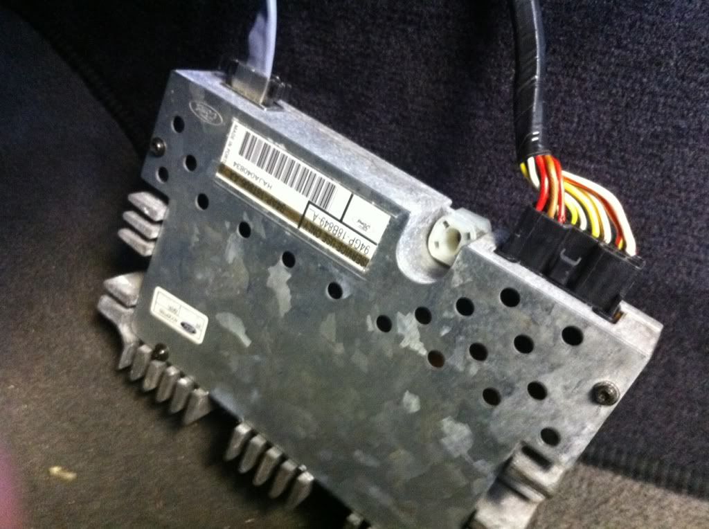

    Hi guys & girls, I'm still having shed loads of grief with changing the car stereo. Everything is working except I have no sound!! When I plug in the original stereo all is ok but even using the correct lead adapters the amp doesn't seem to work even though it does seem to have power.
    I know some people have got this working, so what did you do? What wires do I need to sort?

      I had an adapter that used the ribbon type lead just tried to google it and can't find one like it, will have a look through some old photobucket pictures and see if i can find it
        I had the same problem you have 8 speaker wires and 3 others that go to the amp 1 is a battery feed 1 ignition feed and a earth make sure you have 12v at both feeds as i didn't and all worked fine with 12v

            Sorted it!! It was the new adapter lead after all that! All working perfectly

                A pc9-402. You can get them on eBay
