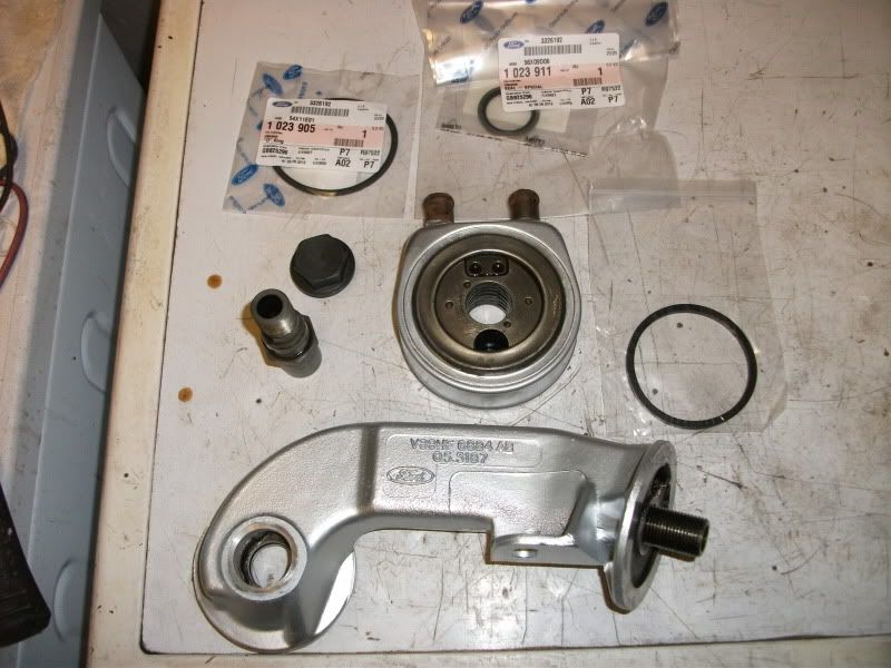

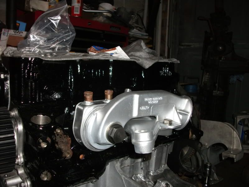

You can get the large nut off that clamps the remote filter arm to the modine, then you can swing it up to remove the engine mounting arm, but you can't remove the modine from the block with the mounting arm in place.
