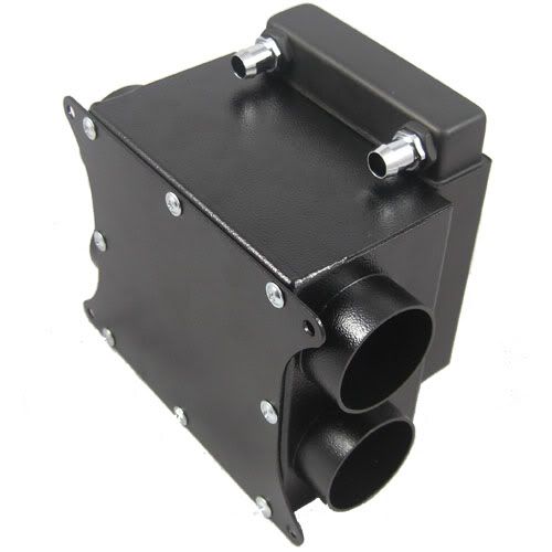

              And also Adam @ T7Design.co.uk who specialise in making small lightweight heater units for kit cars etc.
              www.t7design.co.uk

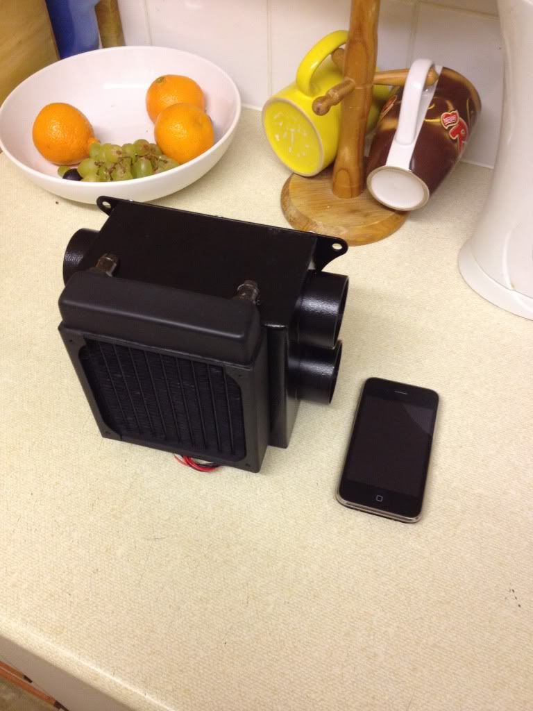

              Because I want the car to be usable/practical on the road in all weathers the fitting of a small heater was chosen even though the car has a heated front screen.
              3.5kw heater unit.............only weighs 1150 grammes :shocked:

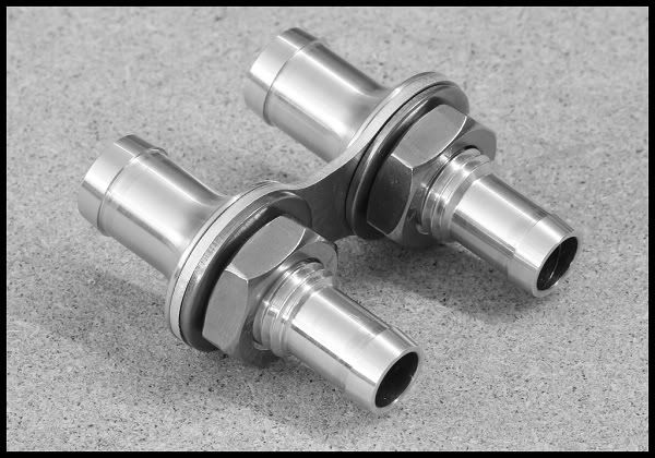

              Billet through bulkhead fittings
              Next to my old iphone to show you how small it is D:

                  get a kit car based heater as ritchie suggests. some will be heavier than the "rally" ones but for the sake of a couple of kilos its not worth paying the "rally tax".
