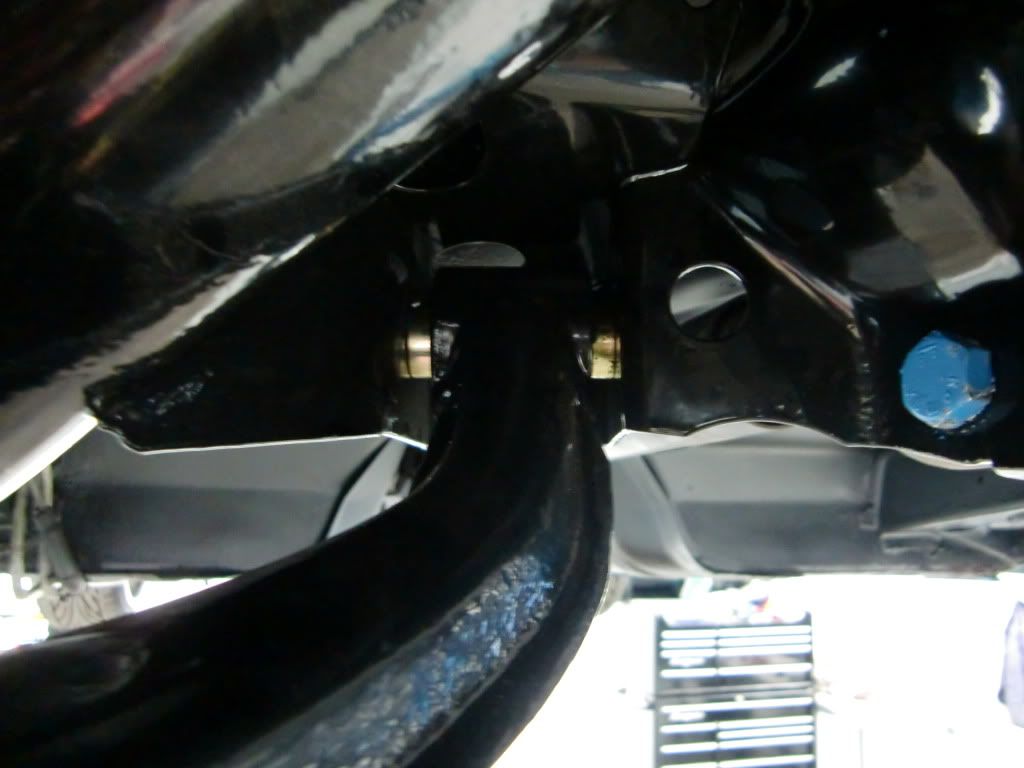

                        If you fit some new trailing arm bushes then don't try using a vice to fit them, they don't like it
                          shouldve kept the Mr Muscle in the tub
                            Jesus Dave, I split my vice fitting mine too.
                            My rear arms with new 'proper' bushes
