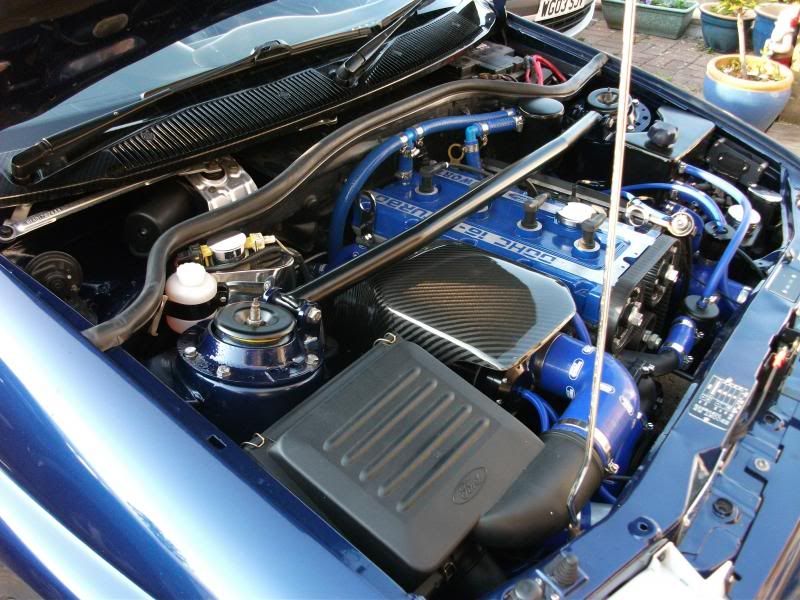

      You will have to change your breather mate as it wont fit
        k & n off and the chorme tank too as it be in the way recon pipes
          I will be swapping hoses later in year, so can I still use the same ones .
            Pretty much everything from the slam panel to the strut top mark and anything below that possibly too.
              Here is a picture of the standard air box fitted. As you can see it takes up the whole space. You will need a new breather system as the mirror tanks won't fit.

                    As others have said you will have to take off the breather tank, and you'll probably find that silicone hose is very tight as well. And you have to take the arch liner out to bolt down the box and fit the air intake. And of course the original turbo heatshield attaches to the side of the airbox too so you might have to fiddle around with that.

                      dont forget you will need the airbox complete with snorkel,the rear bracket,the front bottom extension bracket and a panel filter,so not cheap but you will recoup the costs by selling off your old stuff no doubt

                          no, reroute the breather to tank hose
