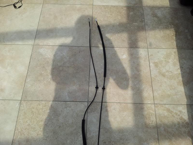

Right I managed to get the bonnet open by grabbing the cable under the dash and pulling it, but on examining the cable the wire isn't snapped but the black outer covering near the orange pull tab seems to have stretched a little.
Not sure how that's happened
Strip down your bonnet catch and give it a good clean up too as they can sieze over time leading to problems needing 6 million kilos of force on the wire to open them!
