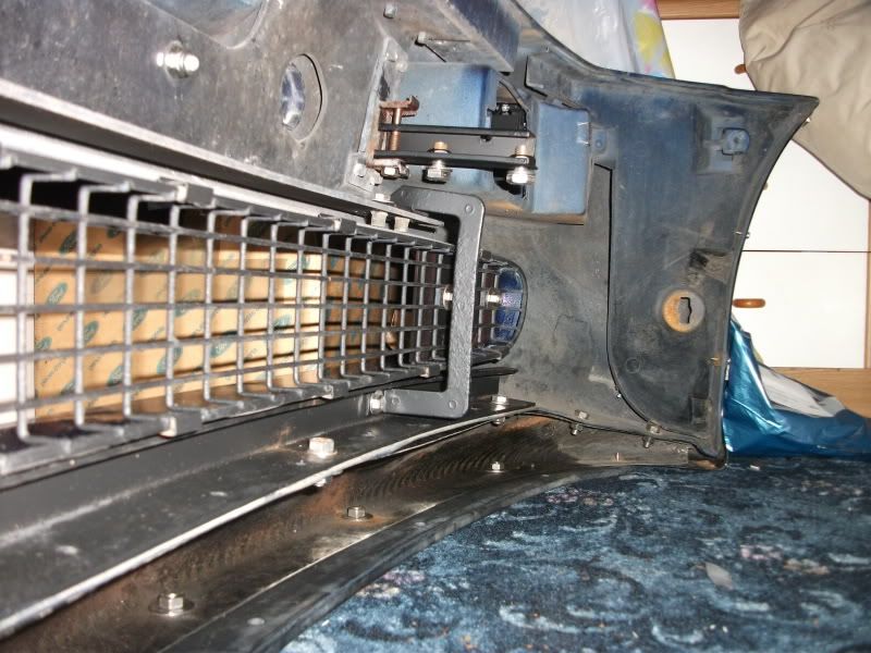

        Here are a couple of pictures to assist.
        First one is the bracket. It has 2 bolts remove the one on the right. loosen the one on the left(closest to bumper). This is slotted on the chassis.
        Second you can see where the plastic securing plugs go.
