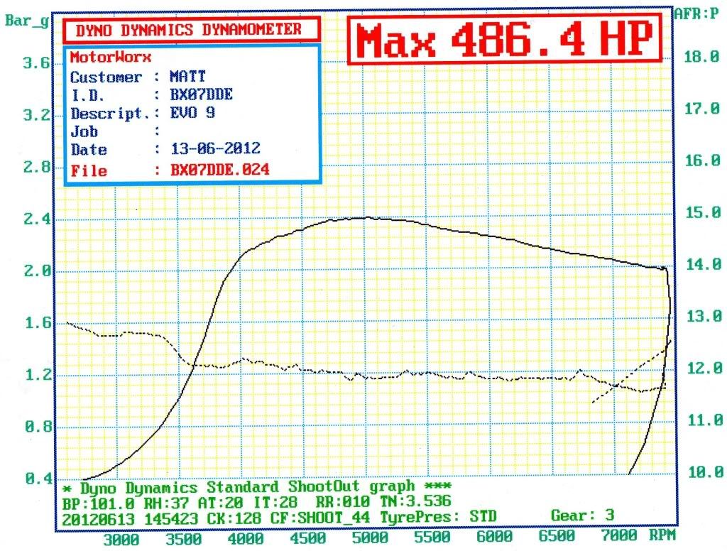

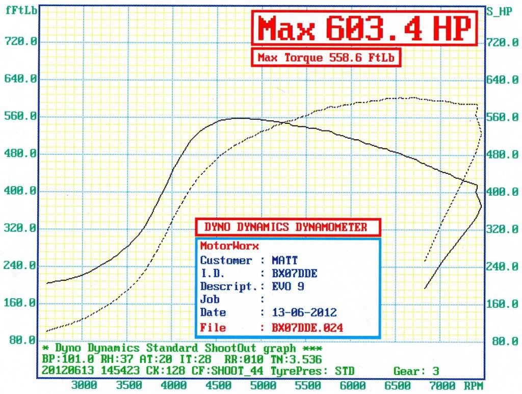

                      The 7670 is running hard at 600hp and is the best by far 600hp turbo I have used,The 8374 will do 650+hp easily and will spool better than a GT30.
                      Do use them on a Twin Scroll manifold.

                          Yes it is a much better turbo than the GTX3076, You will be shocked at the diff.

                              This is on a 2.2lt Evo engine.
