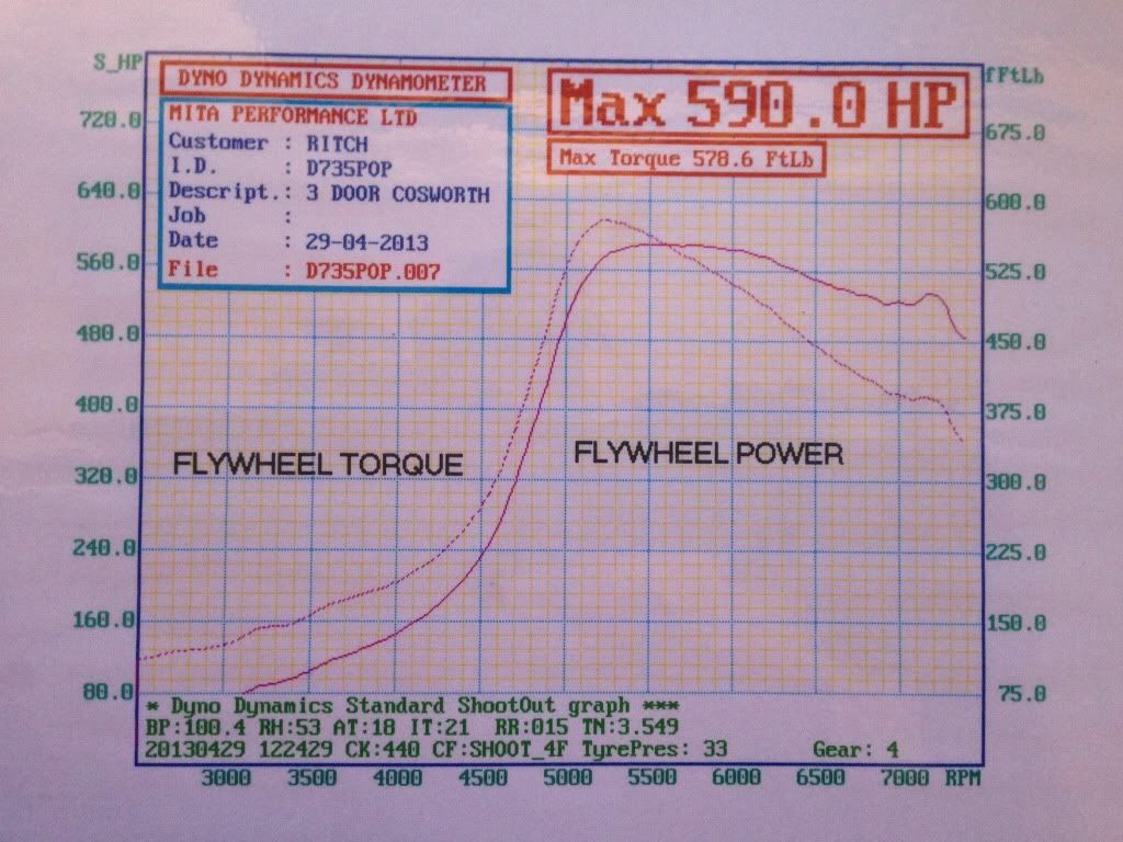

    I've got a GTX3076 with 0.82 housing on and it made 590bhp and 578 ft/lb of torque but ended changing to a 1.06 housing to stop the surge.

          Wow, even with bigger cams and inlet ports?
          590bhp

                  Dear lord.. that must be one of the fastest cossies there... GREAT!!!!!
                  More specs mate? Did any quarter miles or something?
                    This was the engine spec when it made that power (although it has changed abit recently):

                          Apparantly it will where was it dynoed to rich 83s must be on there limit
                            Mita Performance mate, i'd imagine the 83lb's probably are maxxed out.
                            I'm on aftermarket now and 1100cc ASNU's so we'll see what it makes later this week.
