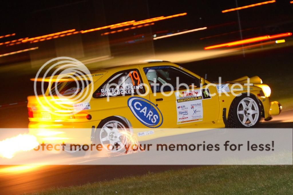

                    Do you really want your road car doing this? Certainly attract the local law, I know from testing this on the road after Harvey had built the engine.

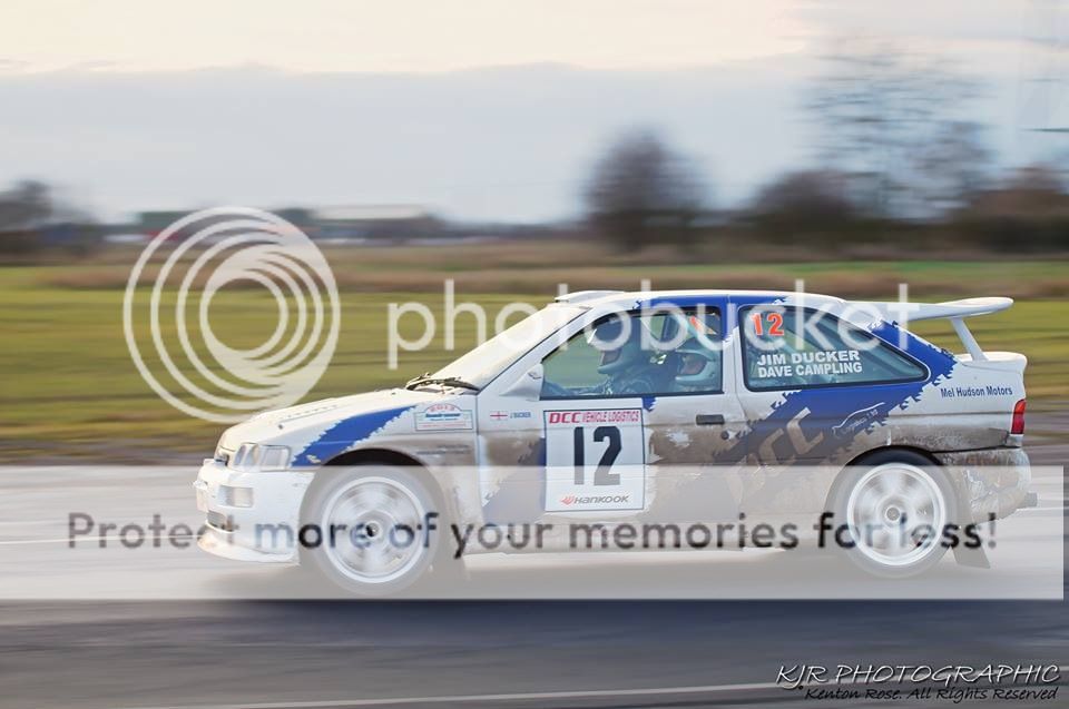

                            Car looks awesome DC Same shell as the one that caught fire?
                            That's quite an old picture taken in 2007 on the Tank S rally in Holland, the location of this photo is one of the rally sponsors filling stations, the stage included driving through the petrol station!! I have not had a car that has been on fire? sold this yellow car about 4 years ago.

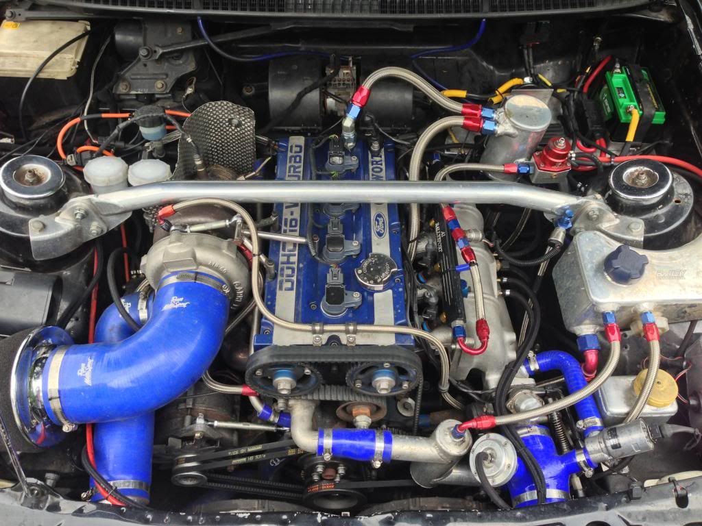

                            This is current car
