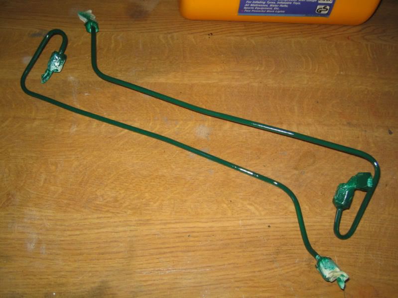

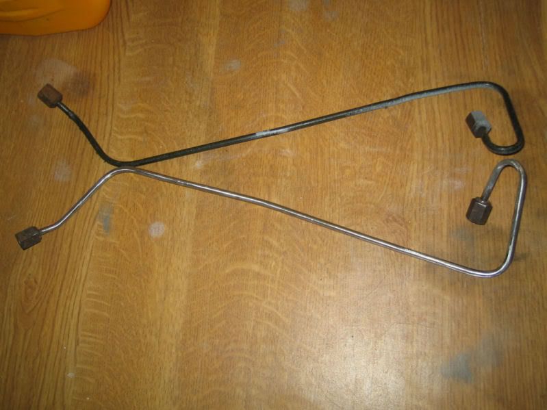

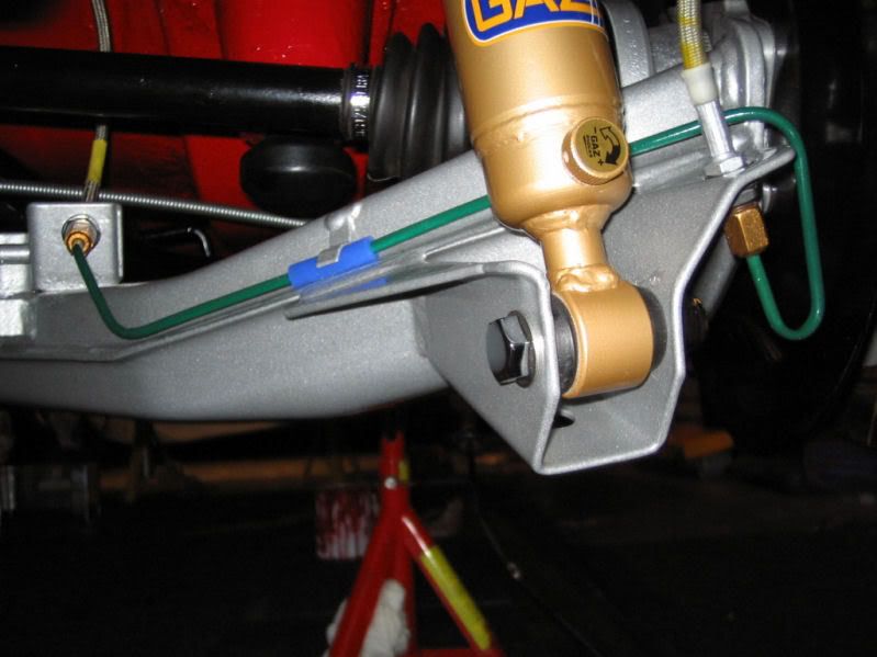

Hi trev, i painted mine when i did my resto. Brake pipes were green and fuel lines were silver. They were linished down first with a wire wheel on a drill and then rubbed very smooth through 3 grades of glass paper. They then had 2 coats of etch primer, 2 colour and then 2 clear, i have gone way back through photobucket to find you a few pics below......
Hope this helps
Mart
Originally posted by redrsmk5 View PostHi trev, i painted mine when i did my resto. Brake pipes were green and fuel lines were silver. They were linished down first with a wire wheel on a drill and then rubbed very smooth through 3 grades of glass paper. They then had 2 coats of etch primer, 2 colour and then 2 clear, i have gone way back through photobucket to find you a few pics below......
http://i103.photobucket.com/albums/m...sto012x800.jpg
http://i103.photobucket.com/albums/m...5/resto139.jpg
http://i103.photobucket.com/albums/m...sto056x800.jpg
http://i103.photobucket.com/albums/m...sto141x800.jpg
http://i103.photobucket.com/albums/m...sto164x800.jpg
http://i103.photobucket.com/albums/m...sto168x800.jpg
Hope this helps
MartIs the gold on the ends painted too?
