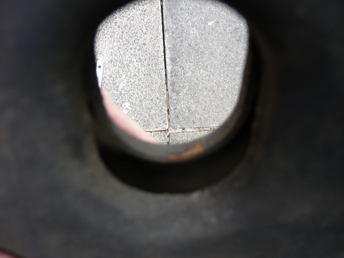

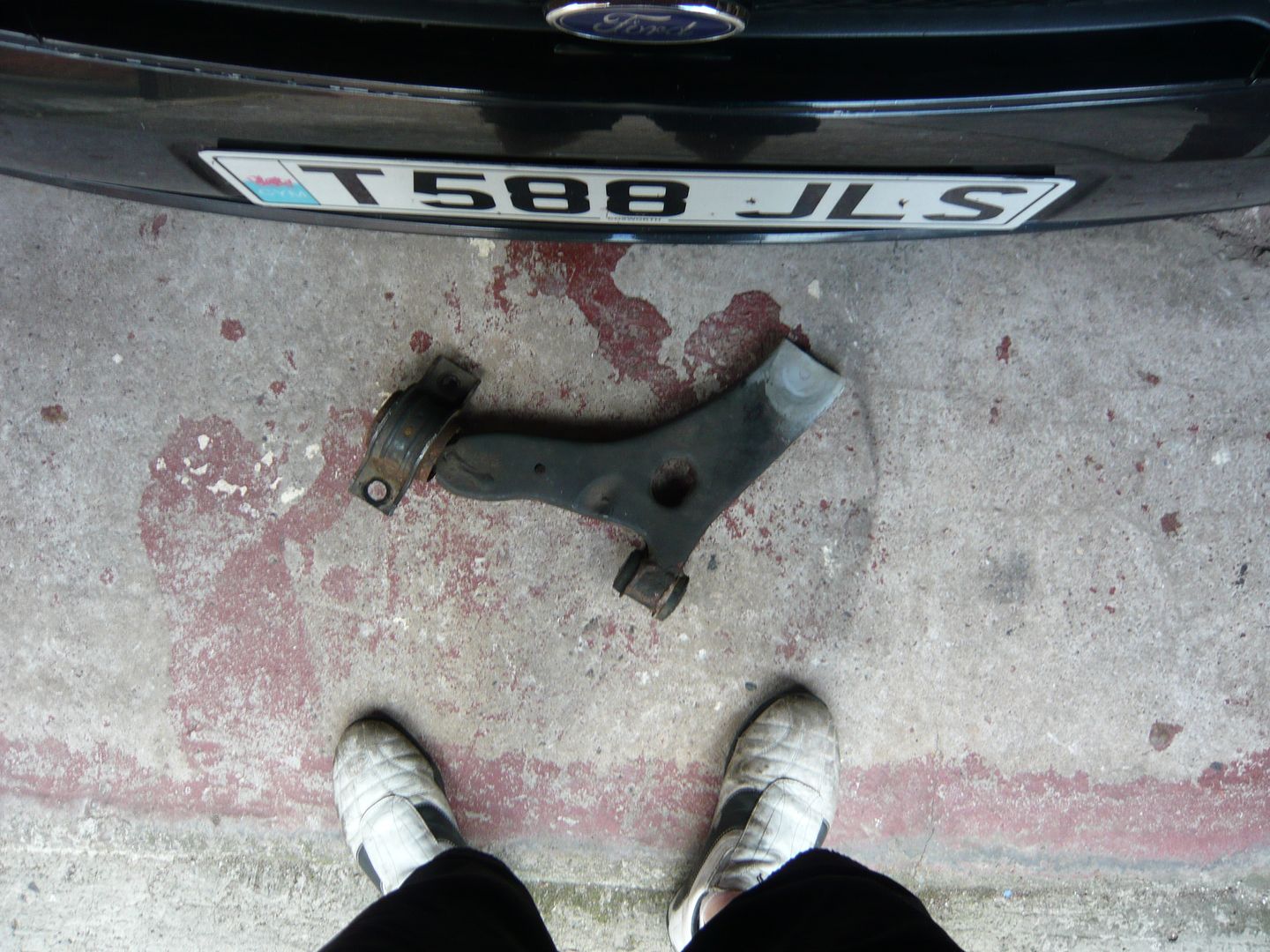

    The topic was the front track control arm, which on the RS is apparently reinforced with an extra internal plate located around the gusset hole and has 2 different bushes. It also costs £350 from Ford, where the standard arm costs £100 all in. But when I cut open the genuine example that has the correct RS part number, I found no extra strengthening plate, the rear bush is larger, but the front bush simply has a 2mm larger insert for the 14mm bolt (standard Focus uses a 12mm bolt). But the bush is exactly the same and we all know Ford bushes even outlast polybushes. To all intent purposes, they are EXACTLY the same.

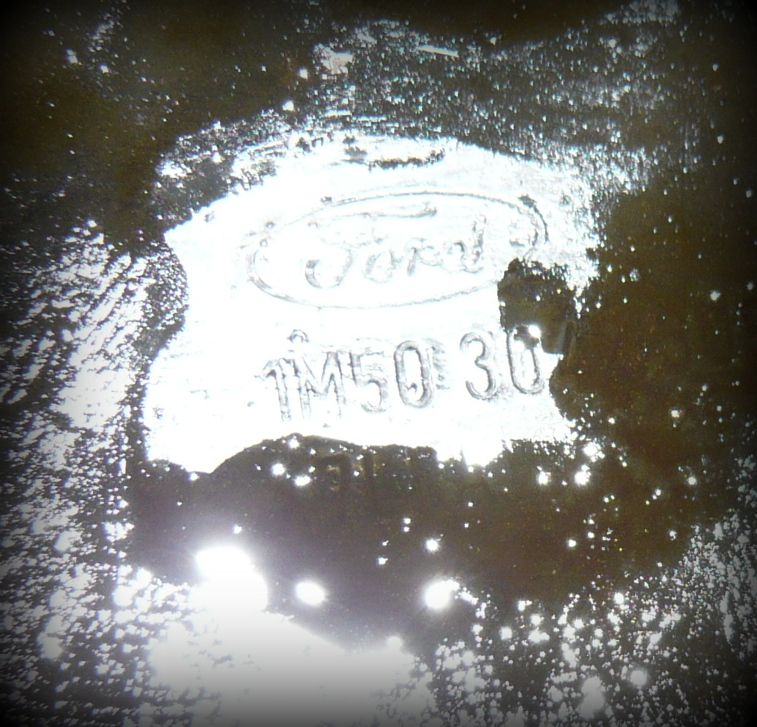

    Here's the arm (sorry about the shoddy grinding, was in a rush to find out the truth). The part number on a genuine RS part starts with 1M50, where normal Focus parts start with 2M51. I fitted a standard arm to the Mrs RS (as it needed a new ball joint, and a full arm is just easier to sort out) and used a lathe to cut out 2mm from the large insert of the front bush to allow fitment of the original 14mm bolt. The rear bush I left as it is and it all fits with ease.
    Best part is, after checking the geometry in the local garage after a hard driving day over the Peak District, both sides still sit exactly the same as each other. No problems at all.
