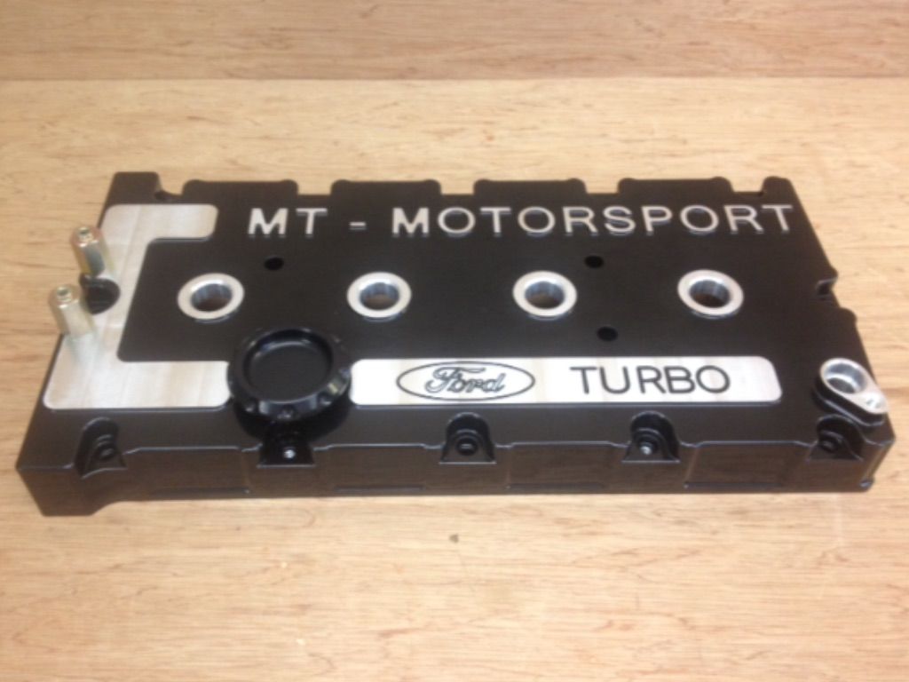

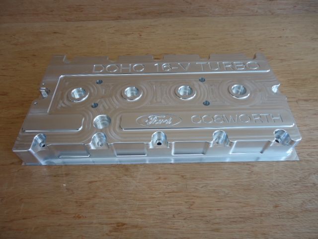

Just look at that rocker cover he has done! That's exactly why it will be s good seller! Takes the new look and makes it look like the earlier Cosworth engine wich most ppl want to see when they open a Cosworth bonnet!
I also like small turbo engines but I am just stating that I think it will sell very well , I think most ppl prefer the BT look

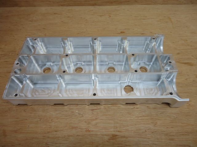

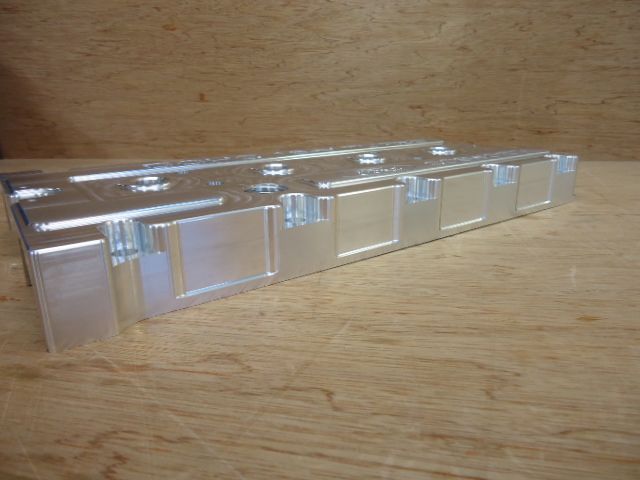

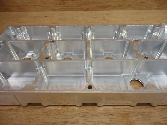

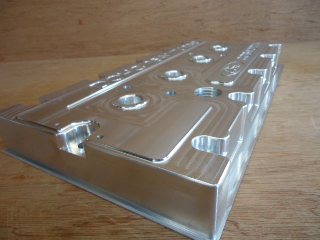

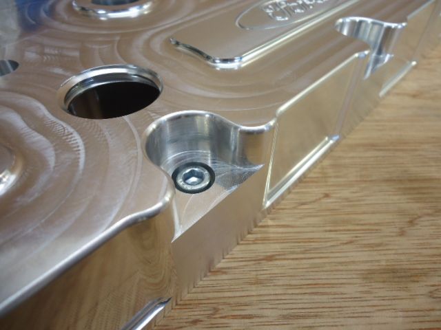

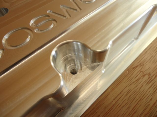

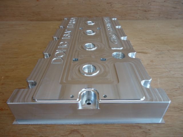

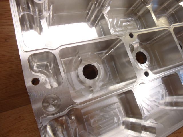

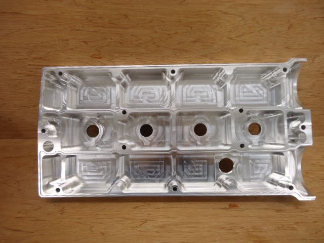

This is my latest Prototype Cam Cover, its a Escort BT one made to fit a ST head, this is for people who have had a BT conversion using a ST head. With the ST turbo head only using 3 bolts down the side to hold the cover on i made this cover look liked it used 5 same as a BT,
I drilled and tapped down 15mm so you can use a small allen key bolt to put in there so it looks like its holding the cover down.

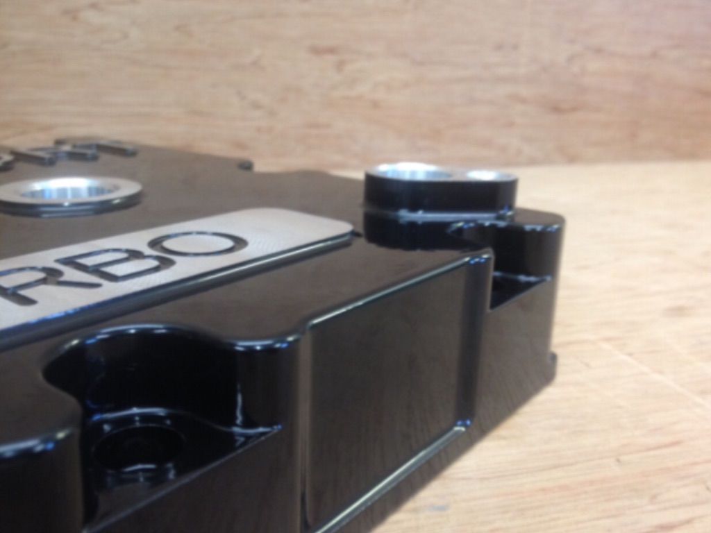

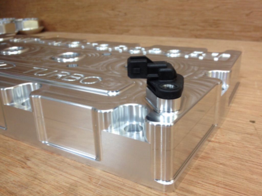

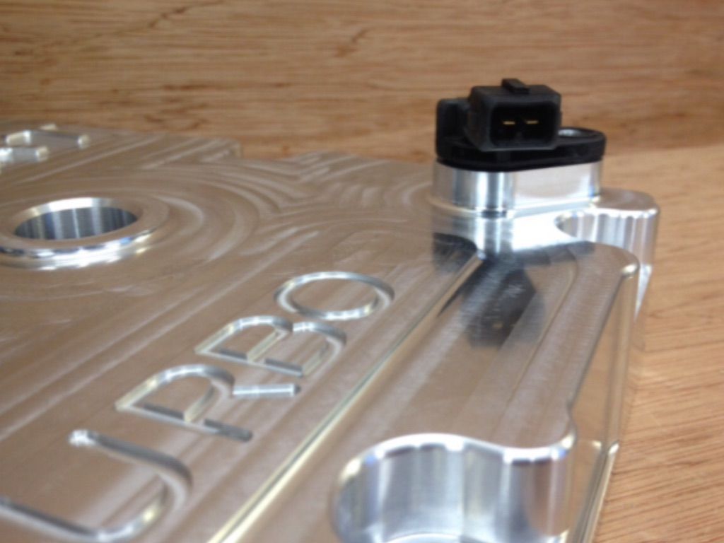

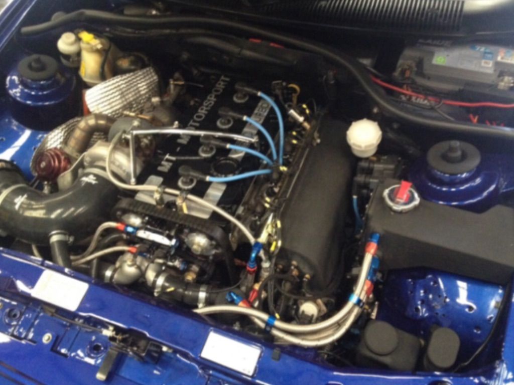

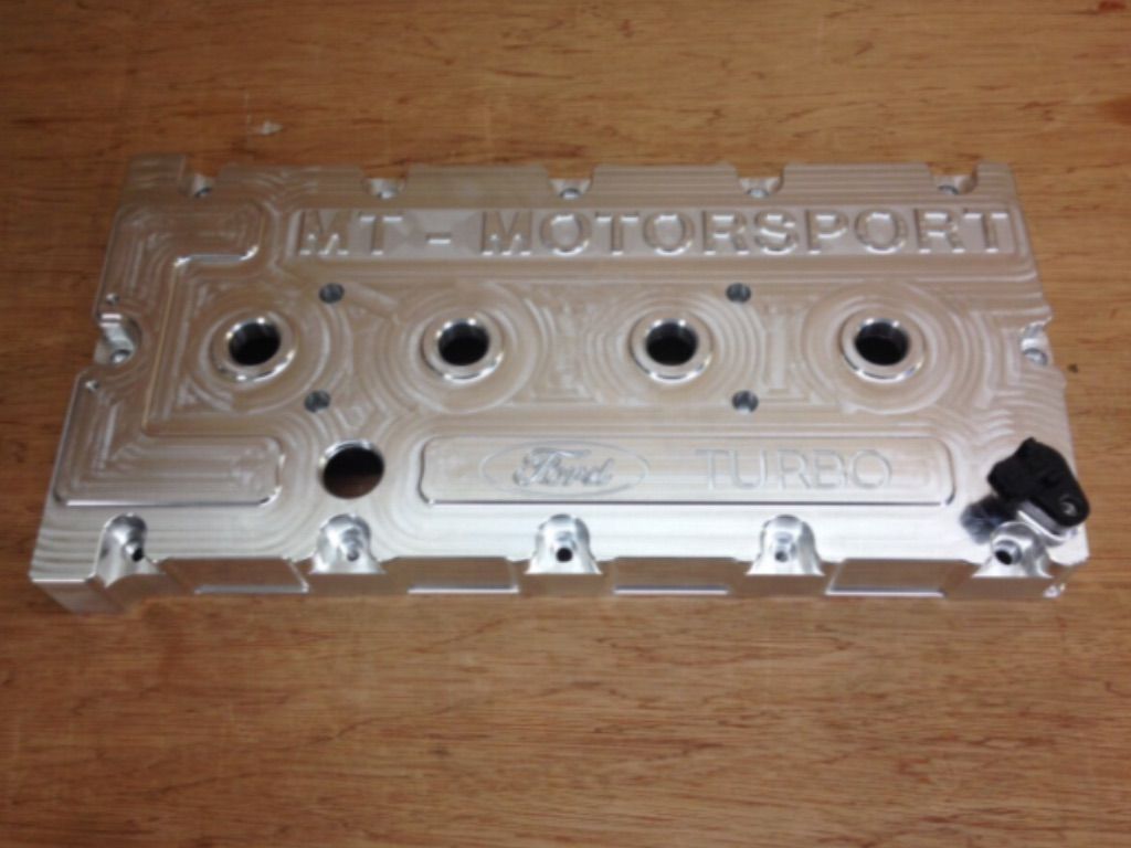

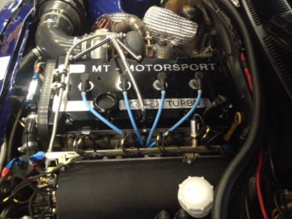

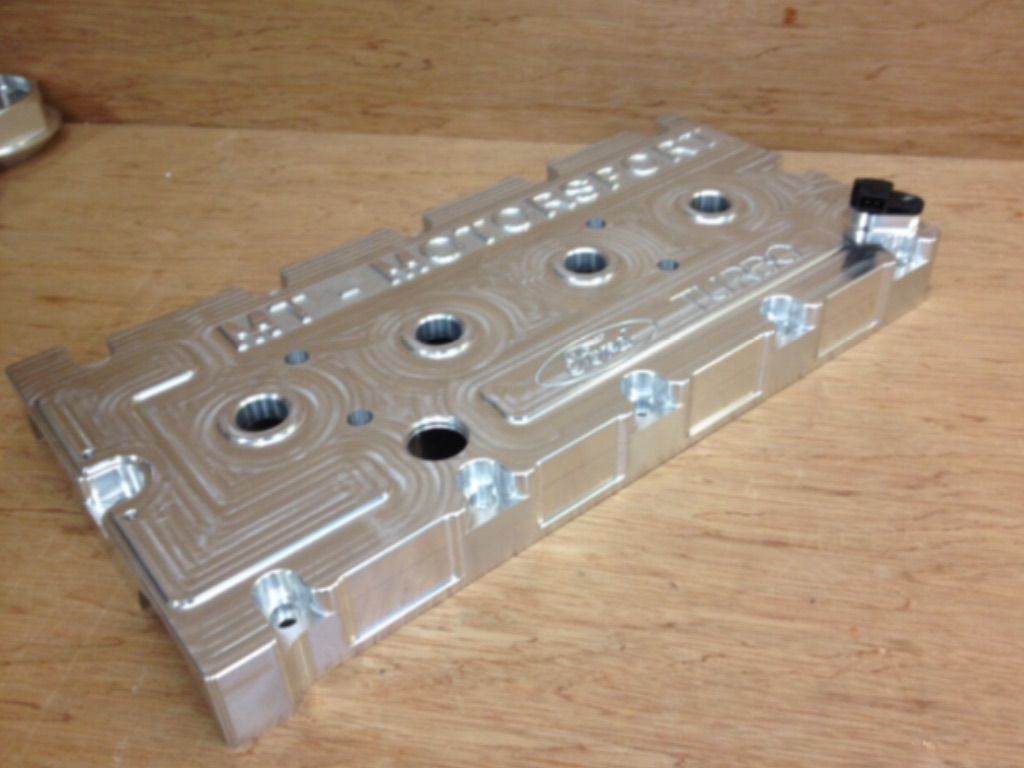

Today I finished my new big turbo to small turbo Cam Cover, I have done this for Steve so I had to incorporate the basket to hold the cam sensor into position. Some pictures of it fitted.
