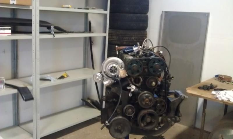

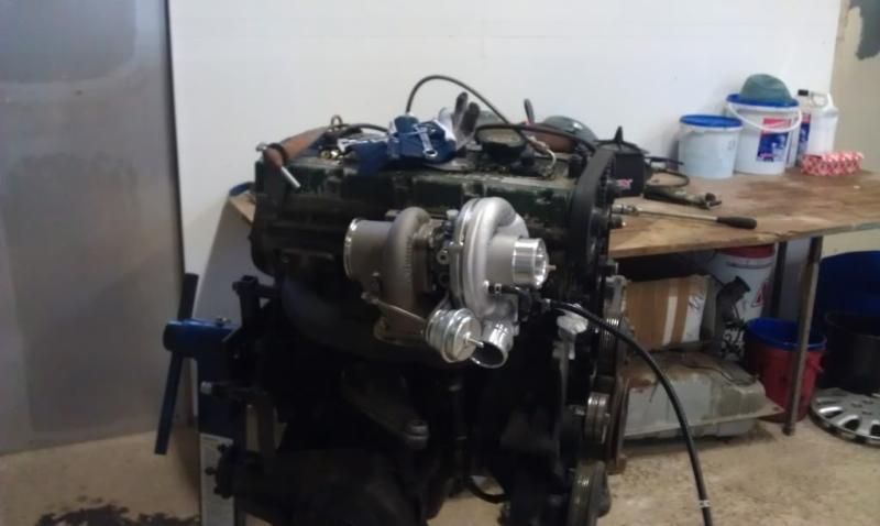

                  I have used the 6758 for a while, but in a rwd sierra. Only made 4 new stud holes in the t25 manifold and there where no clearance issues on a 4x4 head. Had 1,9 bar boost by 3200-3300 so i think the 6258 will be mental. Had no chance att all to get traction in 3rd with new 215/40-17"
                    I have machined the manifold on a st to fit either style exhaust housing. Ill find some pics
