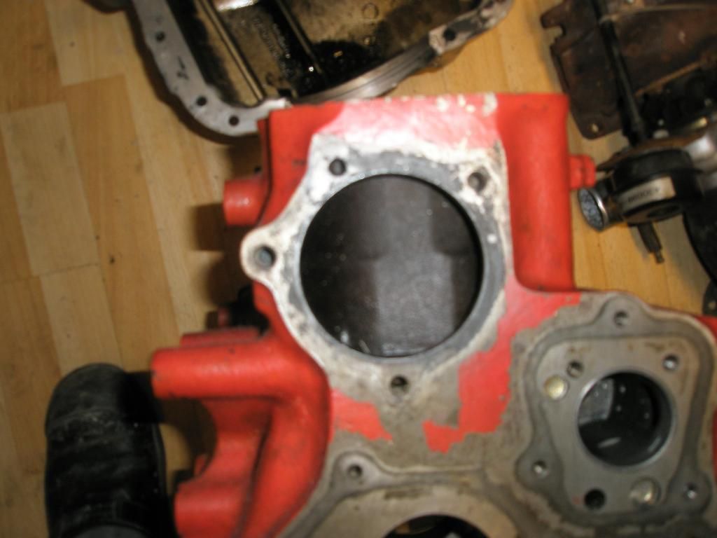

                          had a read trough... one say it looks better then 200, harvey at scs said the where better then 205, but weaker then 200 since the cylindre wals was same thickness all the way like 205, but on mine the cylinderwals is "identical" as 200 and not like the 205, so maybe there is 2 types of theese... I was told that this block was bought trough ford motorsport for his rs500 rallyx car...
                          here are the cylinderwals on mine
                          outside
                          www.sapphirerscosworth.com
