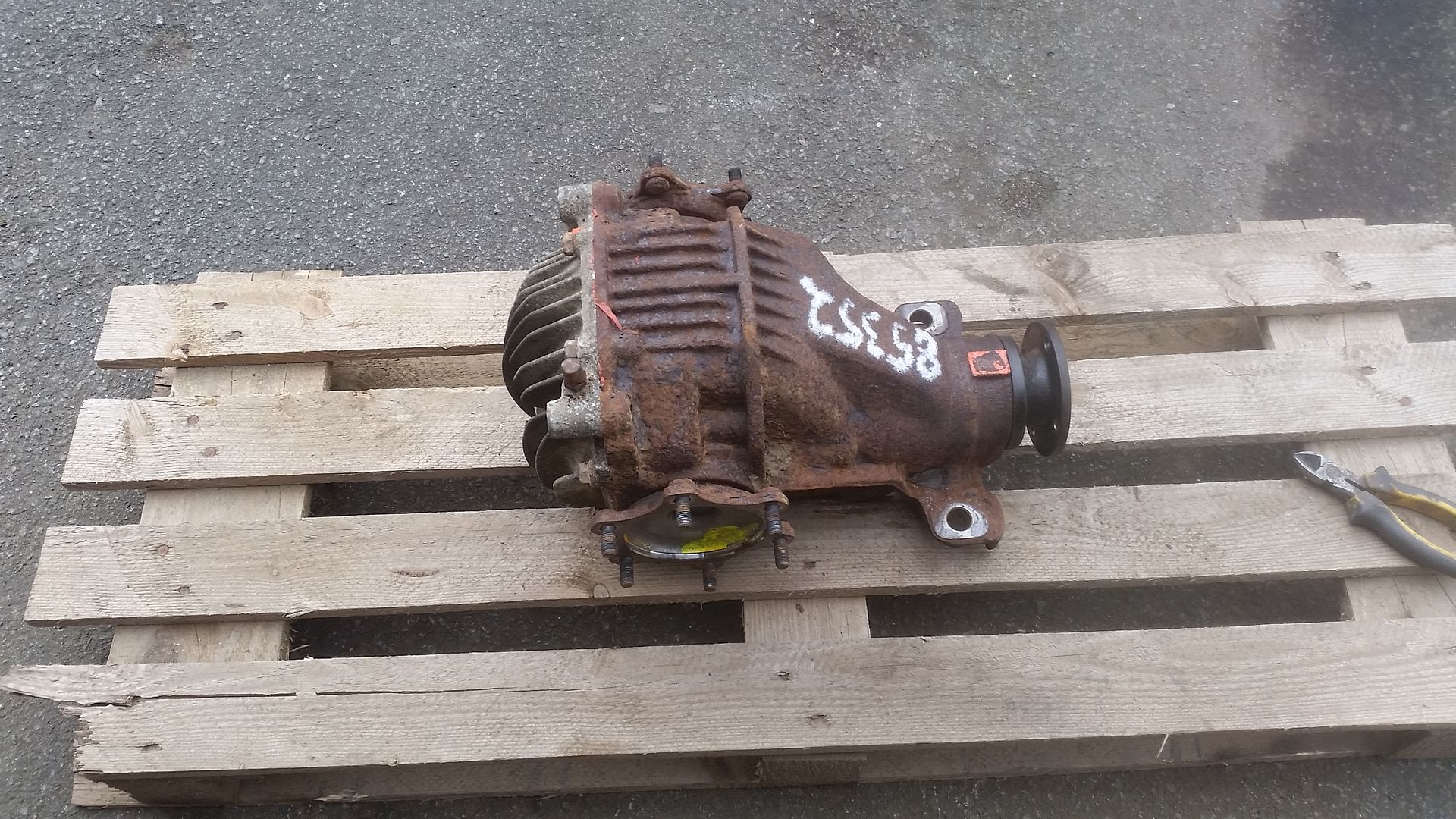

                managed to find a 3.9 hopefully
                breakers in scotland didnt know what the ratio was but gave me chassis number and toyota confirmed it was a 3.9 got it for £80 delivered so be here by friday so ill take the cover off and check the stamping on the wheel when it gets here

                    I know but unfortunately no one is willing to do it so its a gamble ive took if not be a good paper weight but the car looks stock

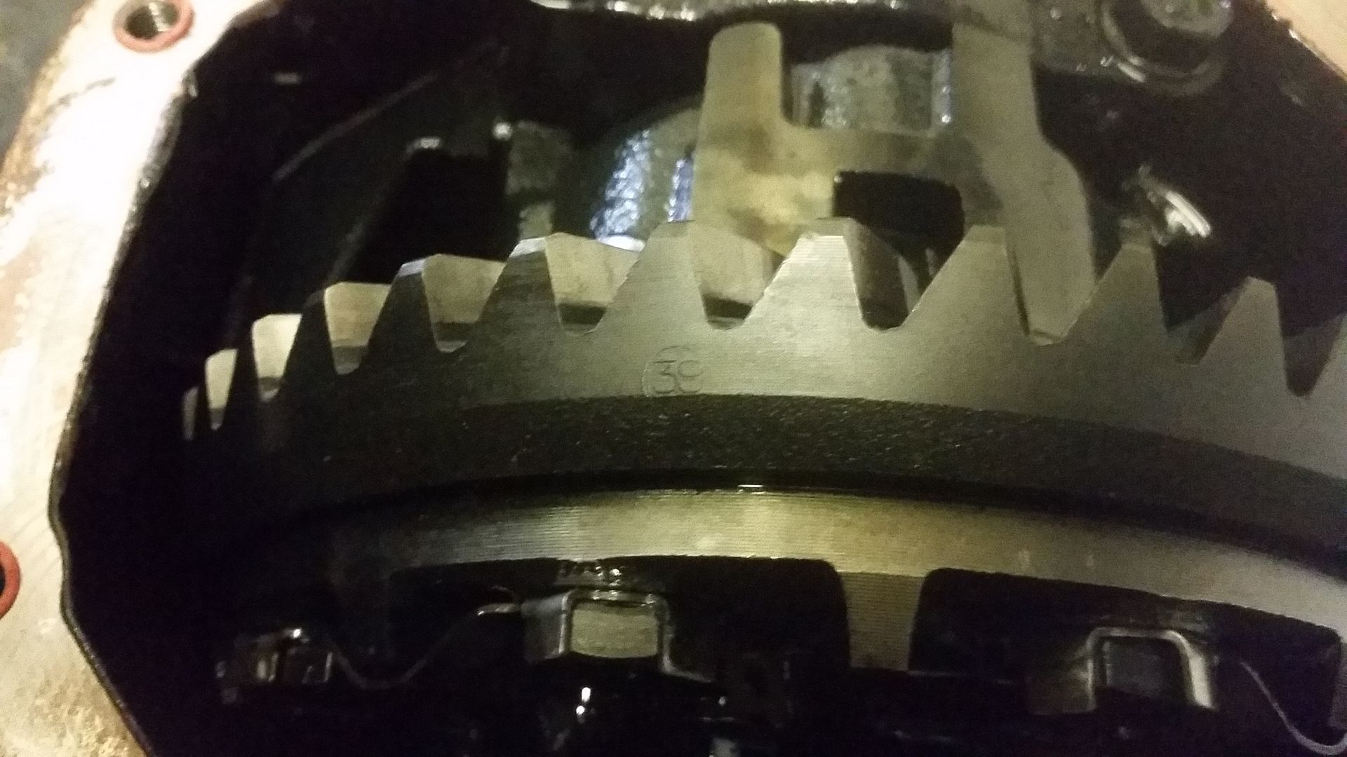

                          good news. i stood the diff on the prop flange pulled off the rear cover and counted the teeth on the crown wheel to find out my ratio for sure. if you are going to change the rear cover plate no time effort lost.

                            the pinion wheel should be stamped with the ratio on it, gonna be a while before its fitted, got to try and find a wheel to test fit first then drop beam for powdercoating

                              My diff has just turned up
                              Took cover off and on the pinion wheel its stamped 39 which is a good sign so counted the prop turns over 10 wheel rotations which gave me 39 meaning it's a 3.9-1 ratio
                              Bargain
                              • #45
                                Result! Looks a decent one too!
