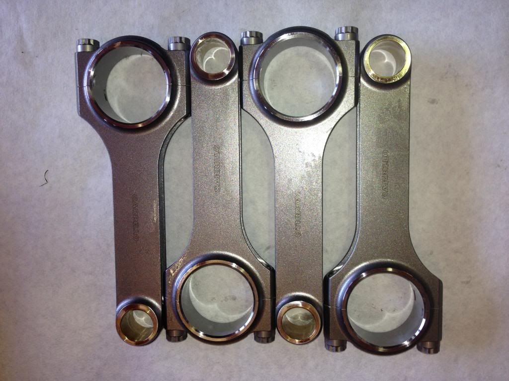

          These are my custom Evo ones.
            These are rated to 1000hp and currently running them at 978hp and 763ftlb.
              Is that what my rods are rated to mark
                Yes.
                  Cp pistons also own Carrilo.
