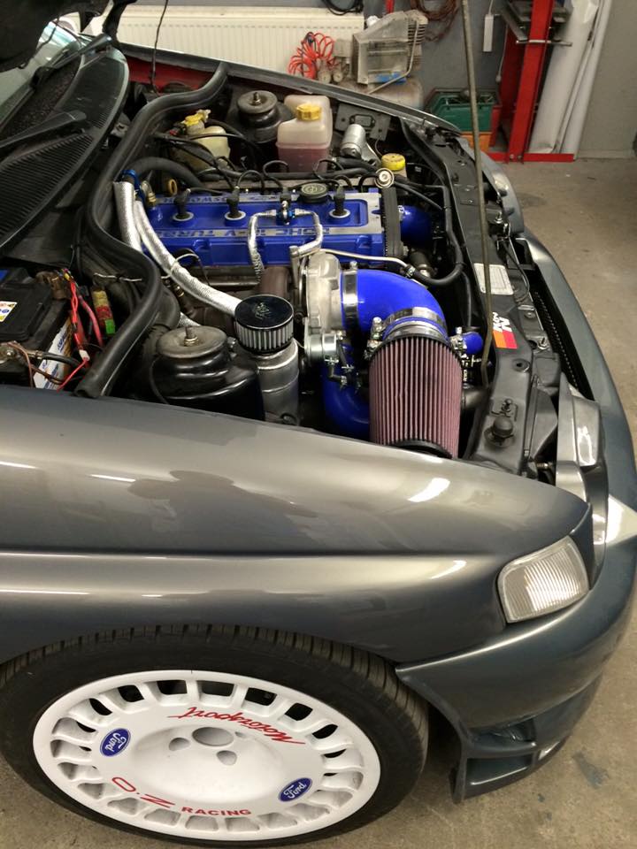

    spec now:
    GTX30/72r
    0,82 A/R
    4x4 manifold
    head and block breather
    grey Bosch injectors
    3 bar map
    mongoose
    large custom intercooler
    stock intake
    stock cams
    the car is late on boost (4000rpm) what can I do to get earlier spool? More mid range power...
    who mapped it?
      They are laggy but a graph would be good to see. If going for 500hp a bw Efr 7064 and the correct manifold with come on boost 900rpm earlier.
        a friend of mine, but the greys are on the limit, have a set of siemens 850lb here, will put them in soon.
        is there any chance in cams? inlet cam with more lift?!?
        how much ignition timing can a YB set to...as there is no knock sensor for the ecu it is hard to find out and we let it at stock setting
          Is it a long stud block?
          Bought and made BETTER
            not yet
              Limited really then, I'd swap to the siemense or light blue injectors. I run a t34.63 on virtually the same spec on light blues, no lag and very responsive.
