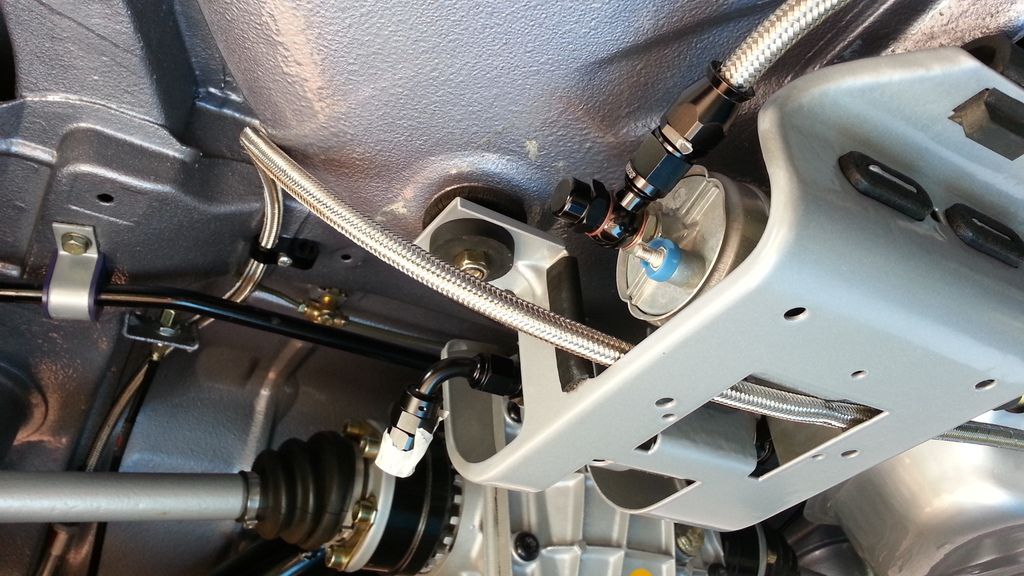

    I'm away to fit a new Bosch 044 to my car, just wondering, have people used the torques outlet check valve?
    I was going to purchase 1 but I don't think I've ever seen them fitted on any other cars I've owned?
    What it says in the advert :
    A check valve is required as after the engine is turned off the built up pressure left between the fuel pump and the fuel pressure regulator has to escape. The exit of least resistance is through the fuel pump if no check valve is fitted. The build-up of back pressure puts stress on the pumps internals damage the pump
    Any info would be great ,

    the oe Bosch valve you think about or another type? if you know its a real Bosch, With oe valve I wouldnt bother to get anything else...

      Not the original Bosch 1 as that's for a banjo fitting, I'm using aero quip fittings

        use a banjo with a jic fitting on then
