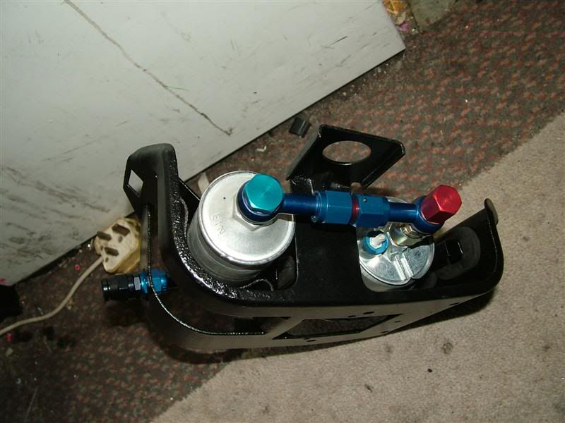

    Finally got everthing covered I think, the tank connections, the fuel filter connections, everything required to make and connect a swirl pot, the fuel rail mods & lastly hoses. Once I've got everything mocked I'll post up a complete list of all parts used, and pics so anyone in the future can pick what parts of the system they may need. My only concern is on the 044 pump, is it ok to remove the non return valve and just connect the pipe straight to it?

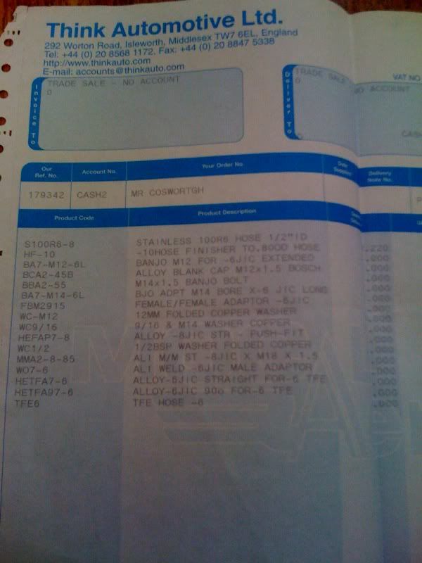

            here is my invoice with their codes on; it may help
            I obviously had the cap and alloy -6 bar but look like some sort of fitment that turns the outlet of the pump to a banjo fitment to use the bar.
            sorry I cant help anymore the car is gone and I did this 4 years ago
            Andy

                  right, looks like you need items 3 and 4 down on my invoice then..........
                  Andy
                    Thanks for that. I think that completes my list. I'll send the email now, and make sure I'm sat down when I read the reply.
