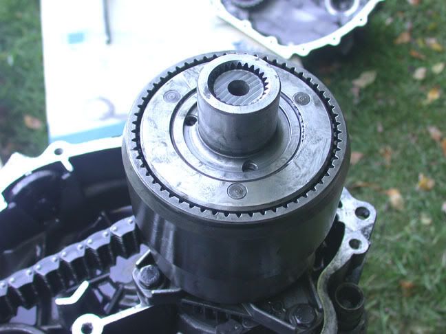

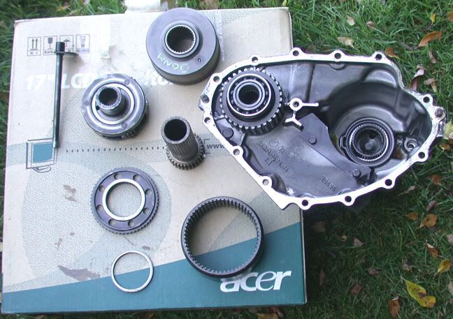

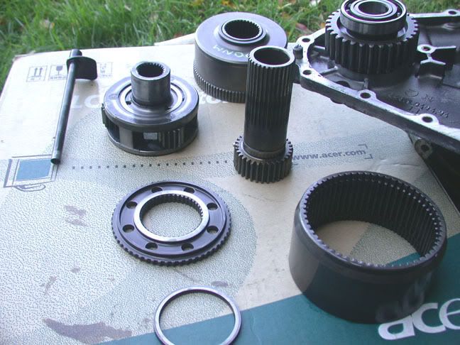

    I would only attempt to do it with gearbox removed from car and then the box stood upright.
    It may come apart OK while in car, but to build it all back up again and re-seal the case you will need to do is as positioned in the pics below.
    In answer to the topic question: YES I have taken one apart, but I could'nt work out how to get it all back together again.........Bara had to re-assemble it for me
