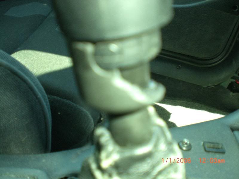

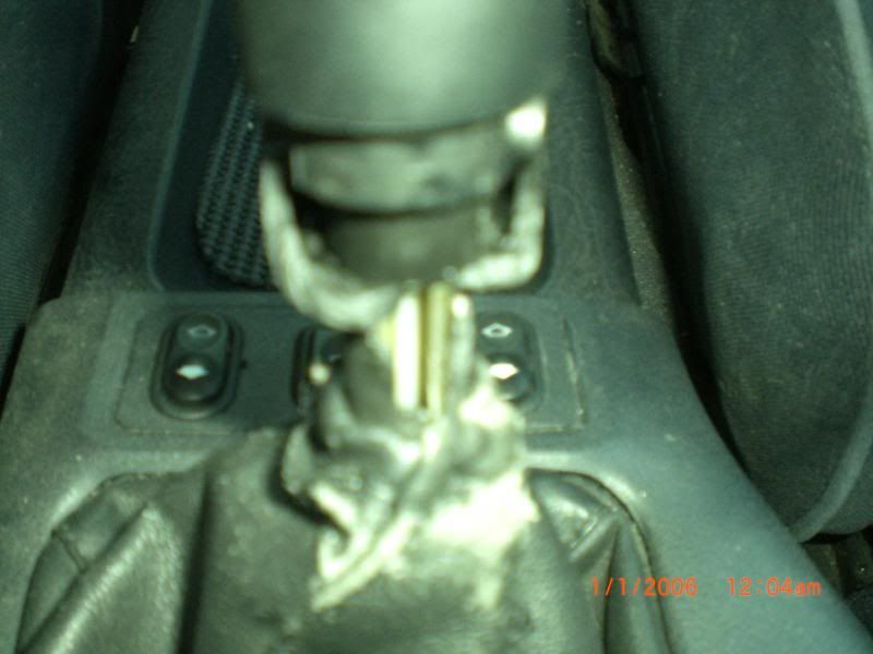

            pics of my busted knob!!!!!!! I think i broke it!!!! pulled the top off it !!!!!
              mines done same went to ford whole gearknob £88 i was going pm monster to see if he do an alloy one
                Thats a gonner Tony.

                You will need a new push on knob too.

                    ok in the 3rd pic of my gearstick can someone tell me how i get the big part of whats left of the knob off.

                              If it is a pull off gearknob that big plastic bit (not the collar) should just pull off (it'll probably take a good pull though). I think I had a similar problem with my old big turbo car. I did this and went to Ford for a new knob, tried to put it on and it wouldn't fit because of that bit that should be still in the knob still being attached to the stick, so I thought they'd ordered me the wrong knob. I think what I did was try to screw my old one off (because that's how my first small turbo car was and I didn't realise the big turbo was different), and so it just mangled up the inside of the knob so it came off but left that bit behind. Hope that's of some help.
                              The collar does look pretty mangled though too as others have said.
