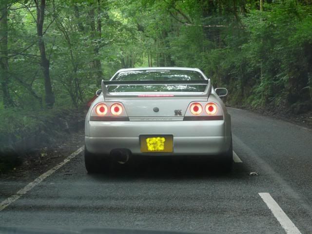

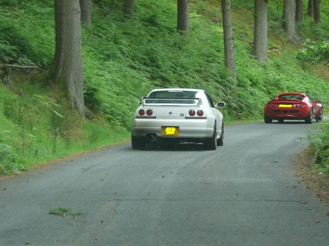

                          I've always liked them and a friend has one - a white R33 GTR running about 375bhp.
                          They seem to need a few revs on them to get going but I like the DRG on them
                          Given lots of money I'd have one ( but still keep my Sapphire ) but talking to my friend the costs have put me off somewhat
                          We went on a run round Wales - they sound nice when revved and certainly hang on well in the corners ( with a bit of tail out action as well ) but he had to fill up twice as often as me...for the same cross country pace
