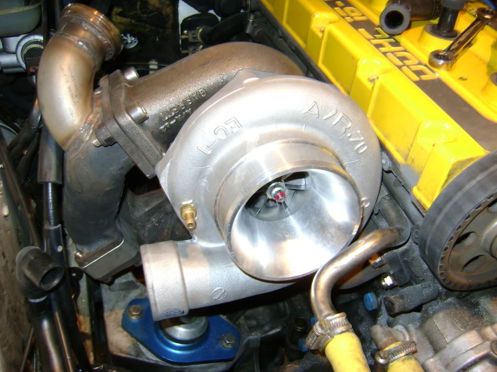

                  i had t34.63 on mine with -34 running 2.2 bar it had nice kick but i wanted more so went for gt30.82 over a t38. in middle of fitting it now hopefully can report how it is some time soon- if still not enuf will also be fitting nos and waiting for transmission to break then replace if it does. quik pic here mate.
                    Gaz, that looks like a GT3076 with a .82 Exh housing

                      thats exactly wot it is kelv fella. looking forward to see how this one is along with 83lb injectors and loads of boost.
                        your getting there gaz m8 looks good im back on a t4 now
