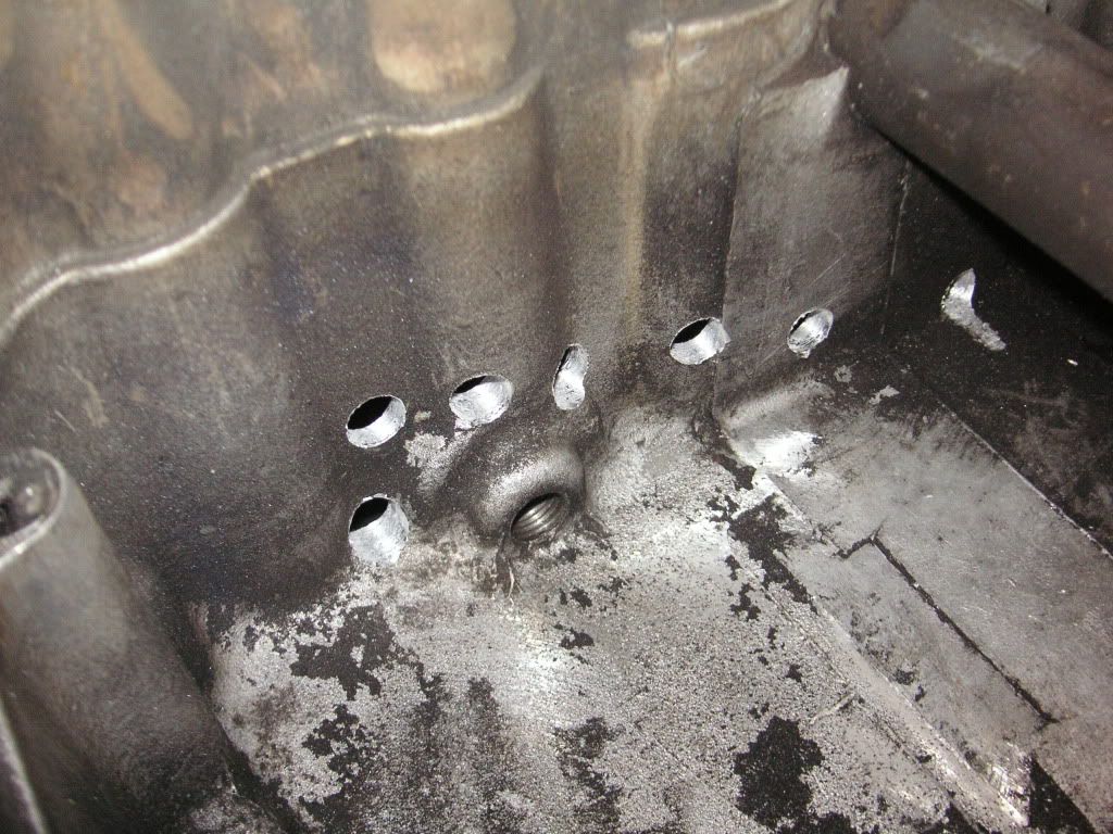

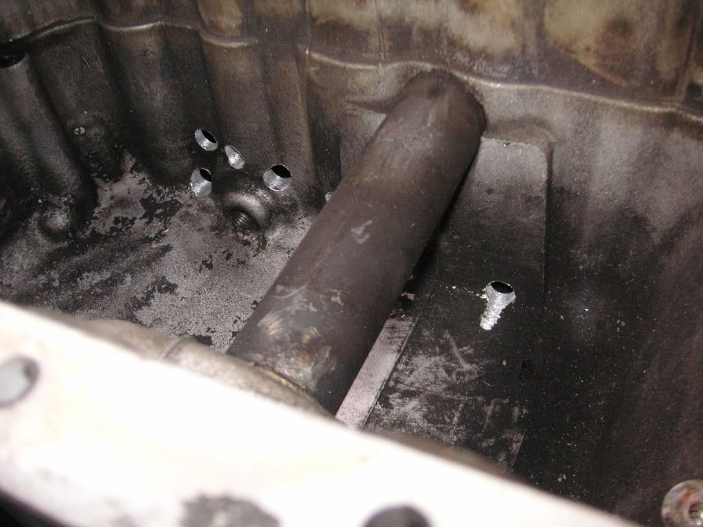

                      how many holes should you have between the sump and big wing section?
                      mine came back like this
                      is that enough?
                        Fit a proper gatted baffle setup, they dont cost much so you may aswell do it.
                        88 Sapphire RS Cosworth
                        53 Focus RS
                        05 Mondeo ST TDCI
                          thats shite lol.
                          do it properly Mark.
                            Lol well that's how I got it so need to see someone elses to see how there's has been done
                            Worried about drilling it out More as the swarf will be hard to get out now the big wing is welded up!
                              the holes is not the problem, get the gated part in the sump,you will be better with it in.
