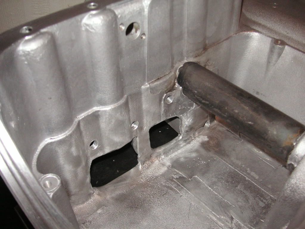

Do you run any kind of gate/ baffle in your 4x4 big wing sump?
    Got Gus to show the pic of the sump to tommy field for me today and he said the same!
    Needs roughly dozen 6mm holes along the top and then more across the bottom and slotted in to one big slit along the bottom,
    He also advised running a gated baffle, has anyone got pics of there sumps drilled out and slotted etc
    And of the gated baffle?
    Thanks Marc
      Marc you need a hole almost level with the top of wings so it doesnt just stay filled with air .
      I would fit a baffle also

        Had my big wing sump modded and the holes at the bottom opened out into 2 large squares with some holes across the top to let the air out the big wing
