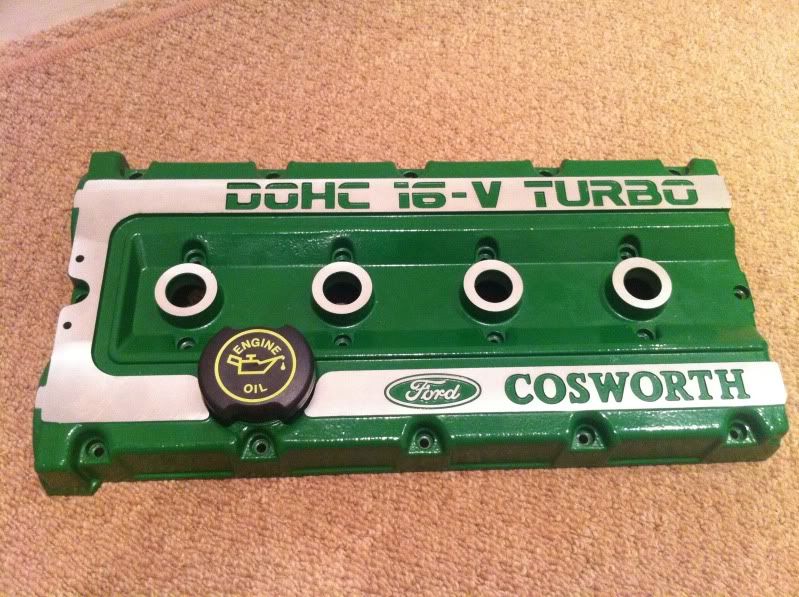

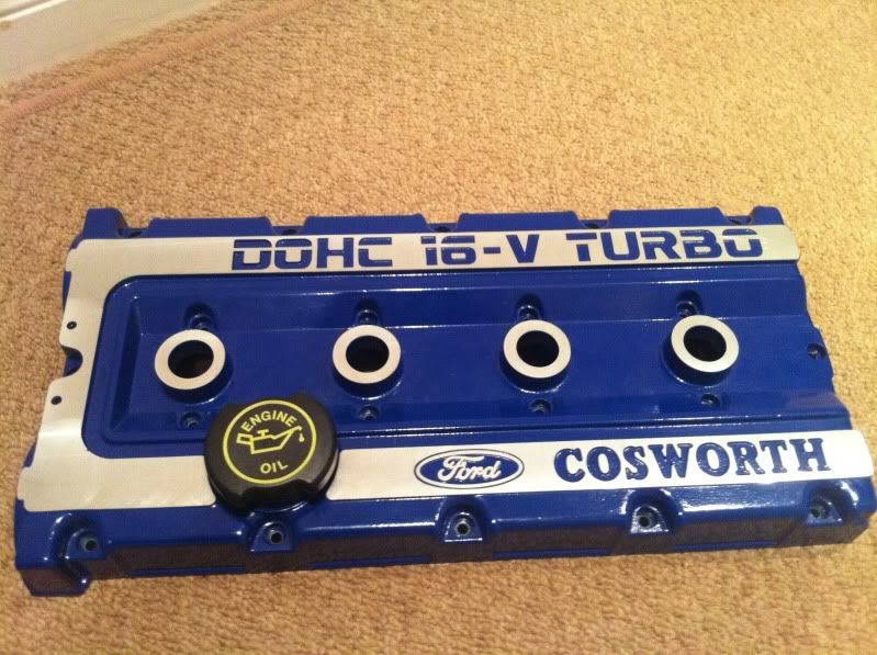

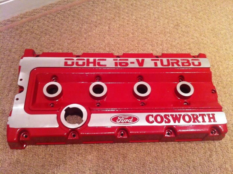

    Here is 3 i got poweredcoated then machined. The Iphone pictures dont really do them justice.

      They look mint! Are they professionally sprayed at a sprayers or done with aerosols?

        Hello, i got these powercoated at a local powder coaters in N.Ireland then took them to a machine shop to get the top face milled.
        If i remember correctly they only charged £20-30 to blast and powdercoat and £25 to machine them.
        Im not sure what exact colour the blue was, just one i picked from a chart.
