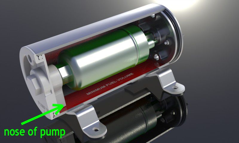

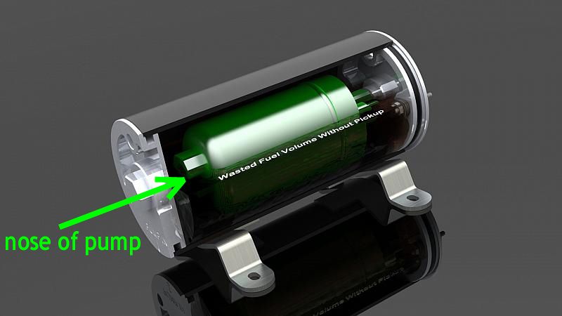

            can i not put a angle inlet pipe to bottom of tank to work
            Look at the two images below: Note the angled pick-up on second image, it makes full use of the tank volume by picking up from the very lowest part of the tank.
              http://img.photobucket.com/albums/08...zzhighnose.jpg
              http://img.photobucket.com/albums/08...zzzlownose.jpg
              cheers m8

                ok got a reply there no inlet pipe on pump
                so where can i get one made or a fitting to make more use of the swirl pot
